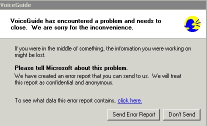

Yeah, still problems....now gives fatal error everytime I try to use the autodialer.
Reinstalled OS, VG, and Dialogic. Dialogice card checks out perfect. Wave driver shows installed in device driver and working properly. VG said wave driver not installed, so went through the VG for Dialogic patch. The system will now work with autodialer, but when it dials each number, a windows fatal error warning pops up. If the call ever goes through, then the feature I have to send calls to a live person will not work.

Thanks for your help.
Still gives me the traditional XP error once in a while - but it only occurs when I select "Start dialing": "VG has encountered a problem and will need to close. You may lose any unsaved data." Then it gives me the option to send the error to Microsoft. Funny thing is, even after the error pops up nothing happens. The program keeps running and nothing seems to be affected except I click "Don't send" to get rid of the error screen.
Haven't seen it quite as often during the last hour of testing as I just installed the XP Service Pack 2, but still have startup problems because VG has not been registered with MS.

Could never find the correct .prm file to change, but when I changed the flashhook length in the config.xml file we found success!
The other problem I am having is when I run the AutoDialer for a second session of dialing after any boot. For example if I have a fresh boot of the pc, and run VG and autodialer there is no error. However, if I complete a dialing session (no matter the number of calls in the session), and begin a second session - the the error appears. Attached is an image of the error.
Glad to hear the transfers now work OK...
Does the error you display always pop up on second start of the Telephone Number Loader app?
Is the previous instance of the Telephone Number Loader app still running?
I had the same problem as the post above with the Dialogic version of VG. I had to go back to 5.2.3 as I have not had time to deal with the issue. Let me know if you find a fix.
