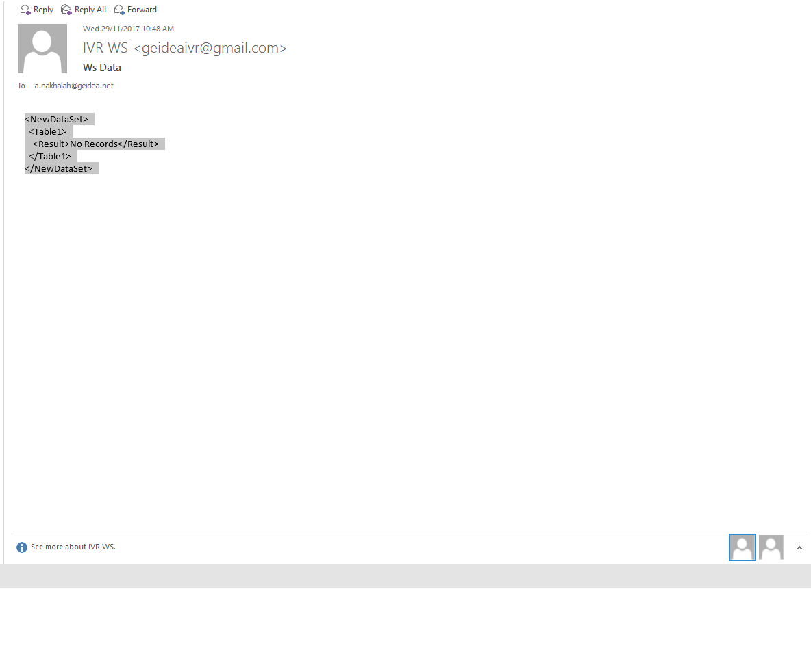

Dear VG team,
i have used WBS recently and am getting connection with my server and returning back the data like in the below as shown in Vgengine.txt
<string xmlns="http://192.168.1.199/">&lt;NewDataSet&gt;
  &lt;Table1&gt;
    &lt;Result&gt;No Records&lt;/Result&gt;
  &lt;/Table1&gt;
&lt;/NewDataSet&gt;</string>

#7 ahmed.muneer 29 November 2017 - 05:51 PM
but i tried to use  $RV[Ws_ValidateTid_string] to be sent to my email i received on the below format , see the attached image.
<NewDataSet>
  <Table1>
    <Result>No Records</Result>
  </Table1>
</NewDataSet>
#8 SupportTeam 29 November 2017 - 06:12 PM
Looks like VoiceGuide is converting the &lt; and &gt; tags into "<" and ">" respectively before saving the string into $RV.
What arrives from your web service is a string, not XML (a string wrapped in one XML tag).
As per last post, try using:
InStr("$RV[Ws_ValidateTid_Result_Data_QE_Doubled]", "&lt;Result&gt;No Records") > 0
but best if you get your web service to return all as XML.
