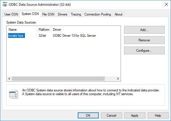

Is the ODBC DSN created as a "SYSTEM" type DSN, or as a "USER" type DSN?
The ODBC DSNs need to be created as a "SYSTEM" type DSNs in order for them to be usable from Windows Services (VoiceGuide runs as a Windows Service),
Also, the 32-bit ODBC Administrator application must be used to create the DSN, so the DSN is accessible to 32-bit applications. (VoiceGuide is a 32-bit application).
Please see: http://www.voiceguid...gdatasource.htm
Below screenshot shows a "SYSTEM" type ODBC DSN created in a 32-bit ODBC Administrator.
When using a 'Run VBScript' type module to access the ODBC DSN that module must be set to execute the VBScript using an 'external interpreter' - as opposed to using VoiceGudie's default ''internal interpreter'.
External interpreters that are available on all systems are Windows' own cscript.exe and wscript.exe
The selection of using the 'external interpreter' can be done by setting the entry Engine in VG.INI's [moduleRunScript] section to cscript or wscript (or wsh) and then restarting the VoiceGuide service. This approach would result in all VBScripts running in VoiceGuide callflows to be executed using the external VBScript interpreters.
Alternate method is to set the $RV[ini_moduleRunScript_Engine] in the VoiceGuide script to cscript or wscript (or wsh) just before running the "Run VBScript"  module that needs to use the external interpreter, and then set it back to ClearScript if any other Run VBscript modules are ran later during that call.
Using $RV[ini_moduleRunScript_Engine] lets you change dynamically between using external and internal VBScript interpreters during the VoiceGudie script itself.
VoiceGuide's Internal VBScript script interpreter runs much faster then external ones do, so its recommended that external interpreters are only used when necessary. (eg. if accessing databases from with VBScript).
