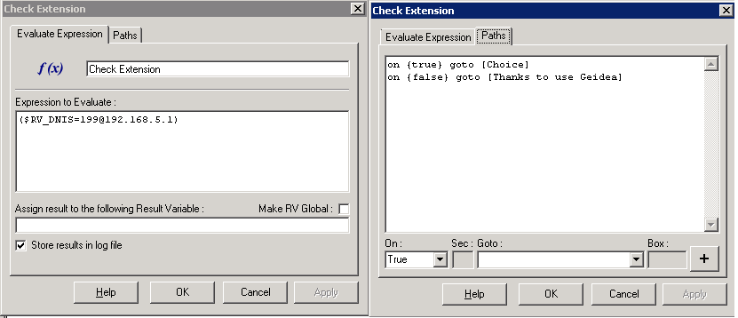

#5 ahmed.muneer 06 November 2017 - 09:46 PM
Dear,
i have used as you mentioned in the above but always it fails, refer to the attached screen shot and related files.
#6 SupportTeam 06 November 2017 - 09:54 PM
The expression should be this:
"$RV_DNIS"="199@192.168.5.1"
note the double quotes. They are needed as the comparison is made between strings, not numbers.
Also, the Config.xml currently on your system is not formatted properly.
vgEngine trace shows:
144106.988   6         ERROR v7.5.6436.27381 (2017-08-15 14:12:42.36) mainLoad XML Config : Name cannot begin with the '<' character, hexadecimal value 0x3C. Line 23, position 65.
To check Config.xml formatting please try opening the Config.xml file in any web browser.
The web browser should indicate any XML formatting issues in the opened file.
