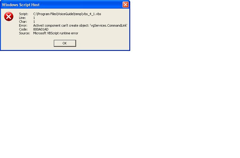

I am on v6 and tried to do following:
set vg = CreateObject("vgServices.CommandLink")
vg.Record_Start $RV_LINEID, "c:\newfile.wav", 1, ""
set vg = Nothing
But error window says ActiveX component can't create object 'vgServices.CommandLink'
No such function for v6?
Was this VBScript ran from inside a VoiceGuide 'Run VBScript' module, or from an external VBScript?
Can you post the VoiceGuide traces capturing the system startup and the call during which this script was called?
(Please .ZIP up any traced before posting)
Why didn't I get email when the question got replied. I should have come back earlier.
Nothing to do with the log. It's program error. Attached is the pop error window and the vgs source and the log.

In v6 the COM interface is VoiceGuide.CommandLink.
vgServices is used in v7.
Please change;
to:
set vg = CreateObject("VoiceGuide.CommandLink")
(the Help file that is is installed with v6 has the right object name used in examples)
If it still does not work, then are there any Anti Virus apps installed on this system?

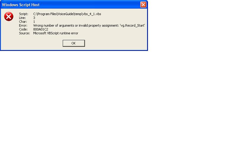

Notice the error is different now.
The error now is "Wrong numbe rof arguments in Record_Start function call'.
Previously the error was that CreateObject call could not create object.
So looks like now the CreateObject call is fine, and the object is being created, but there is something wrong with the Record_Start function call.
In VoiceGuide v6 the Record_Start function does not have the sOptionsXml - Record options field. That field was added to VoiceGuide v7 API. Please see the documentation that is installed along with VoiceGuide v6 on your system. The online documnetation shows v7 API.
In your VBScript please change:
vg.Record_Start 4, "c:\newfile.wav", 1, ""
to:
Can you also describe in more detail what do you want the system to do? Why are you using a VBscript module to do the recording instead of just using a Record module to do the recording?
