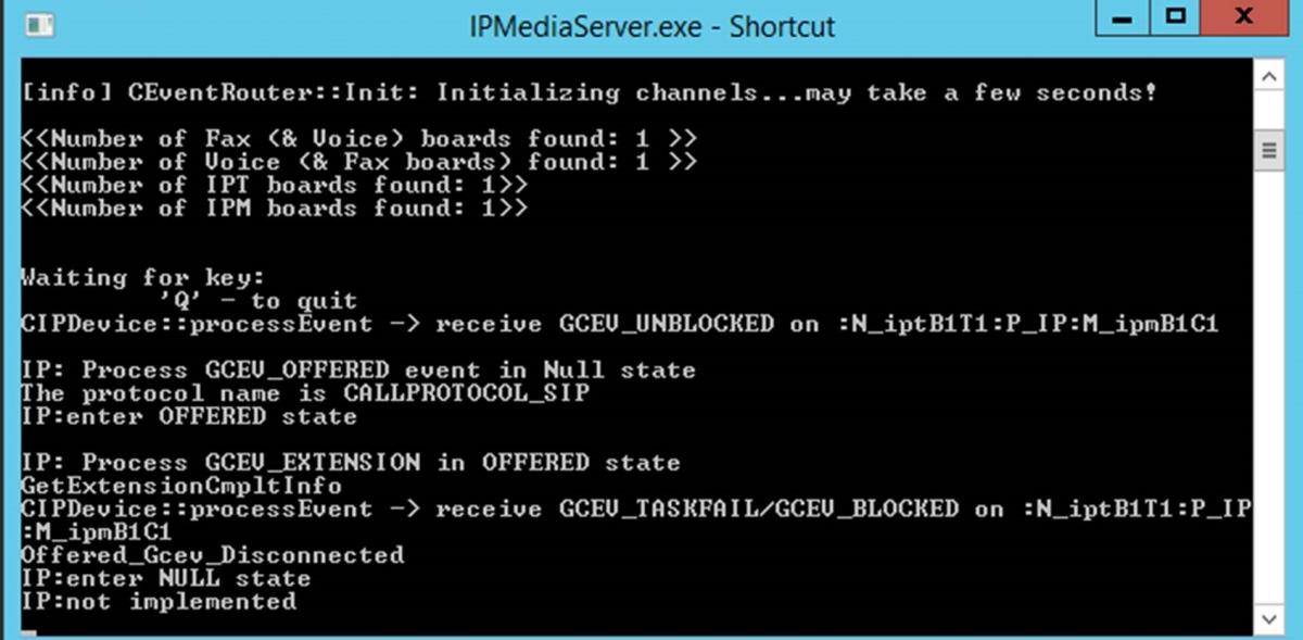

#1 SupportTeam 02 January 2018 - 07:21 PM
Customer wrote:
We are using Windows server 2012 64bit operating system with Bria xlite softphone.
Please note we have not yet registered with sip service provider because it is still in the testing mode.
1.server 2012 IVR setup done which is located @ datacenter.
2.softphone is setup on my local machine windows 10 which is connected to public ip.
3.when I dial the with softphone can see this message on server side:-  IP Media server no voice response.
4. server 2012 operating system does not have sound card drivers setup is it ok ? OR IVR Needs sound card ?
#2 SupportTeam 02 January 2018 - 07:27 PM
Does this server have multiple network interfaces?
If yes then please stop the Dialogic HMP service (using DCM), select the card, go to Config -> Default IP, and select the 'first' IP interface. Then start the Dialogic HMP service again (using DCM) and try running the IP Media Server test again.

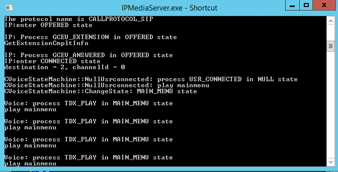

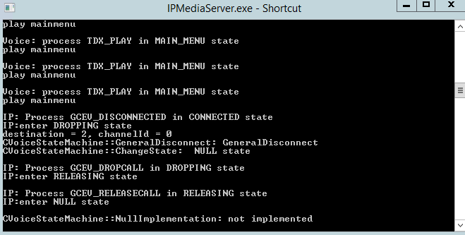

#3 satishkumar1066 02 January 2018 - 08:56 PM
Hi,
yes this server have multiple network interfaces.
stoped the dialogic hmp service done in the Config ->Default first interface ip is set and started DCM Service.
on server running with IP Media Server for test yes i can see the screen playing MAIN_MENU State but no sound able to hear on my softphone Bria Xlite  can you guide.
screenshot listed below of the server running play and when I cut the call from softphone can see second screenshot.
#4 satishkumar1066 02 January 2018 - 09:06 PM
Hi,
yes the server is having multiple nic cards and set to :- 'first' IP interface now when I dial thought it is playing IP Media server demo but still unable to listen demo sound screenshot attached.
