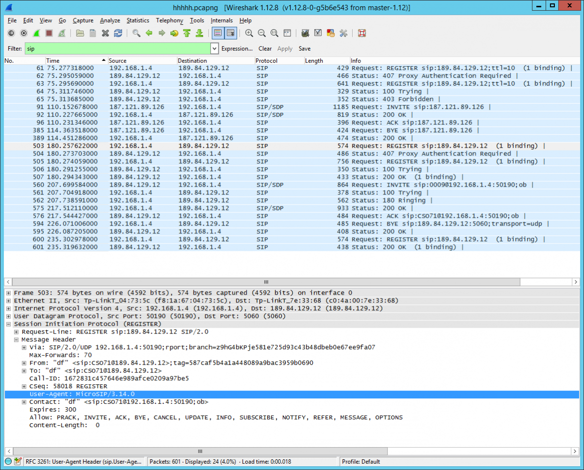

#7 SupportTeam 16 August 2016 - 01:01 PM
As you are using an older version of VoiceGuide you may need to set this in Config.xml's <VoIP_Authentication> section :
<Realm>Directcall</Realm>
Please make that change and restart VoiceGuide service. Please make WireShark capture as before if you still encounter problems, and post the WireShark trace along with the ktTel trace file.
In newer versions of VoiceGuide setting the "Realm" entry is not necessary if only one source of calls is being registered.

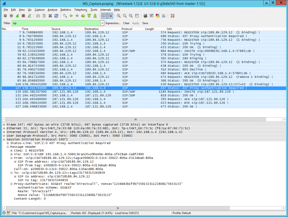

#9 SupportTeam 16 August 2016 - 02:56 PM
It looks like you now have VoiceGuide installed at IP address 192.168.1.4 ?
and there are INVITEs from 187.121.89.126 that come from Microsip?
But there is also Microsip installed at 192.168.1.4... right?
Please ensure that the system that has VoiceGuide installed on if has no other SIP software installed on it. Multiple SIP programs on same system will interfere with one another.
Also please ensure that no other SIP devices or software is trying to register that same SIP number.
Then after uninstalling Microsip (and any other SIP software) from the VoiceGuide machine just restart that machine and capture in WireShark the VoiceGuide service startup (and hence the REGISTER messages) and then place one call into the registered number (via DirectDial / DirectCall)
This should give us a clear picture of what is happening.
Please the post the WireShark and ktTel traces as before.

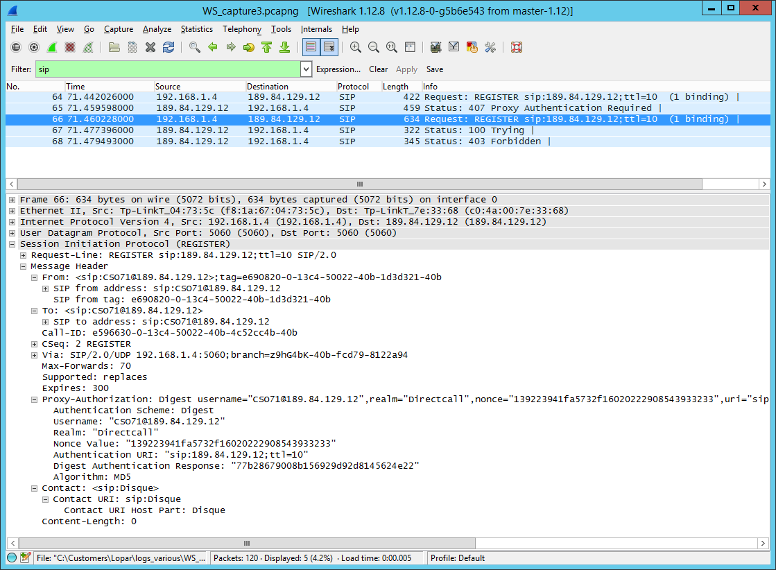

#12 SupportTeam 16 August 2016 - 05:26 PM
We can see that Dialogic HMP is doing registration and is supplying the Digest Authenticated Response, but now the DirectDial / DirectCall SIP server responds with:
403 : Forbidden
You could ask DirectDial why their server is replying with Forbidden, but most likely it's the Alias / Contact setting.
Right now you have the Alias to be just:
Disque
This is not a valid SIP "user@host" type URI expression. Suggest leaving the <LocalAlias> entry (in Config.xml <VoIP_Registration> section) blank, or setting it to a valid SIP "user@host" URI eg: Disque@192.168.1.4 or CSO71@192.168.1.4, so either:
<LocalAlias></LocalAlias>
or
<LocalAlias>Disque@192.168.1.4</LocalAlias>
or
<LocalAlias>CSO71@192.168.1.4</LocalAlias>

#14 SupportTeam 16 August 2016 - 06:53 PM
Attached WireShark trace does not capture any SIP communications.
Looking at Microsip's REGISTER message in WireShark we can see that it is setting the "Contact:" field, so you could try using
or
or maybe try:
<LocalAlias>CSO71@192.168.1.4:5060</LocalAlias>
and see if this makes any difference.
Please ensure that that SIP account is not being registered by Microsip or any other sip agent on another system at the same time.

#23 SupportTeam 17 August 2016 - 01:52 PM
VG gets a 403 forbidden
Now that you are seeing the 403 being returned from DirectCall you should be able to ask DirectCall why they are sending back that response. They should be able to see why their system is responding with a 403.
Every time the VoiceGuide service is started the registration attempt will be made and the REGISTER messages issued to DirectCall - and you can monitor these on WireShark, and DirectCall can monitor them on their end.
