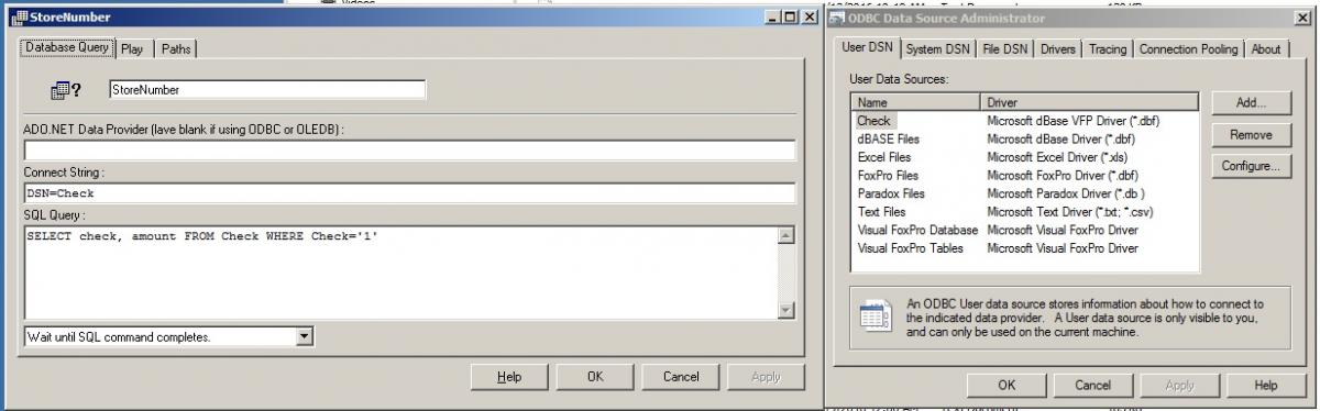

I'm trying to create a script where I can query a Visual Foxpro table with an ODBC Connection and the Query Database function.  I emailed support and they suggested I post with a sample of the table zipped up.
This is the copy of the email I sent them.
ODBC question.
I have a client that has a Visual Foxpro Database.  I’ve created an odbc connection and am trying to run a “Query Database” on it to test retrieving data.  I’m not sure what should go in the three fields.  The odbc name is “Check”.  It is a table that has 3 fields, they are check,amount,iussed.  In other words check number, amount and issue date.  I wanted to do a very basic Sql query and say the amount.  So I’m guessing I could say “Select check, amount,issued from check where check=’1’.  It fails every time.  I’m guessing because I didn’t put anything in the two previous fields.  I’m not sure what goes in the fields ADO.NET or Connection string.  Any help would be greatly appreciated.

#3 jiaseby 14 December 2016 - 02:37 AM
Here is the log requested.  I'm sure the main reason is I'm setting the script up wrong.  Thanks for any assistance.

#7 jiaseby 15 December 2016 - 01:09 AM
Hi I did use the 32-bit ODBC Data Source Administrator.  However there isn't a test function option on the Visual FoxPro ODBC connection like on others.  I'm not sure why.  I've attached the vgEngine.txt file from a test I just did.
#8 SupportTeam 15 December 2016 - 07:01 AM
vgEngine shows error is:
ERROR [IM002] [Microsoft][ODBC Driver Manager] Data source name not found and no default driver specified
Are you able to try ODBC connection string using the driver name instead of just DSN ?
eg. Please see https://www.connecti.../visual-foxpro/ :
Driver={Microsoft Visual FoxPro Driver};SourceType=DBF;SourceDB=c:\myvfpdbfolder;
Exclusive=No;Collate=Machine;NULL=NO;DELETED=YES;BACKGROUNDFETCH=NO;
