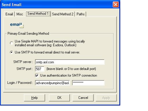

#18 Lbud 27 January 2017 - 11:56 PM
I don't where it came up with that?
I attached a picture of the settings screen.

#20 SupportTeam 28 January 2017 - 06:01 AM
Please change:
smtp.aol.com
to:
ssl:smtp.aol.com
There is a bug right now that if port 587 is specified then this prefix:
ssl:
must be added to the server name.
also, if the connection to smtp.verizon.net on port 465 must be an SSL connection the please specify the verizon server as:
ssl:smtp.verizon.net
