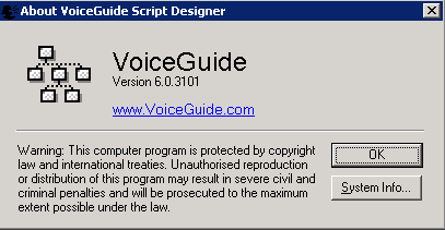

Could you please advice which version of the script designer is used on this system?
Please post screenshot of the 'About' window that is displayed when the "Help" -> "About" menu option is selected.
#3 DrDial_HealthAxis0 26 January 2017 - 12:33 AM
Here is the version we are currently operating on.

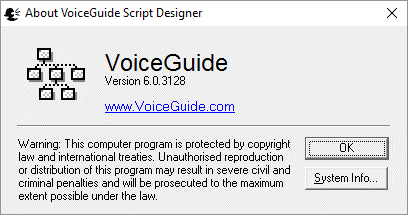

#4 SupportTeam 26 January 2017 - 02:43 AM
The current latest version of the Script Designer is 6.0.3128
It is available in latest version of VoiceGuide.
For updating your system to latest version of VoiceGuide please contact sales@voiceguide.com

#5 SupportTeam 28 January 2017 - 06:06 AM
You can also install the latest version of VoiceGuide on another machine and the copy over the script editor to old system.
The script editor does snot check for license when running and the script editor on evaluation system works exactly the same as when it is ran on licensed systems.
