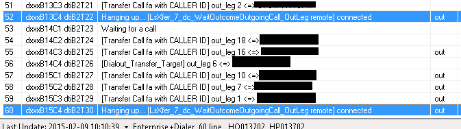

Hanging Up... [Lsxfer_7_Dc_Waitoutcomeoutgoingcall_Outleg Remote]
We noticed that there is often a status on hangup: Hanging up... [LsXfer_7_dc_WaitOutcomeOutgoingCall_OutLeg remote]. We must then manually reset the channel.
What does it mean?
What data You need to verify the problem?
We would need to see the ktTel and vgEngine traces that capture the time when the calls were made.
Please .ZIP up the traces that cover this time and post them as attachments.
Looks like this was sometimes happening when during the trombone transfer the original leg of call hung up at same time as the outgoing call was answered.
This update should fix this issue: [removed]
Please update system to version above and advise if you still encounter issues.

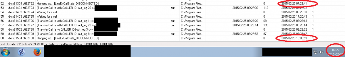

Almost there, looks like another setting needed to be updated.
Please try this version: [old link removed]
Line 424409: 102050.096   7 166  57 state Hanging up... [LsXfer_7_dc_WaitOutcomeOutgoingCall_OutLeg remote] connected
After the update no longer receives "Hanging up... [LsXfer_7_dc_WaitOutcomeOutgoingCall_OutLeg remote]", but now I get: "Hanging up... [LineEvCallState_DISCONNECTED]".
Again, I am sending log files.
