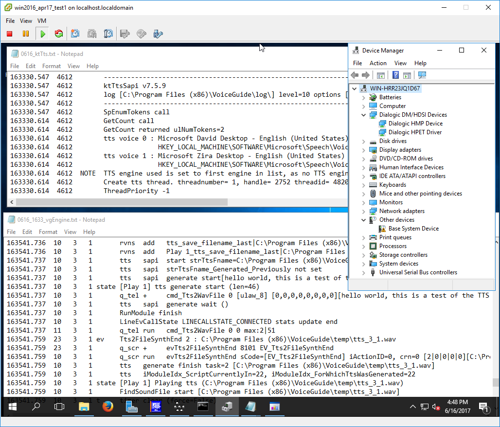

#6 SupportTeam 16 June 2017 - 05:04 PM
We always use Microsoft Text-to-speech.
Current versions of Microsoft TTS do not require that a sound card/hardware be present.
Please see screenshot from a test we just did on Windows 2016 running on VM under ESXi 6.5.0
"Microsoft David Desktop" TTS Voice was used by VoiceGuide and it successfully generated the sound file that was then played out.
Screenshot shows that no sound hardware is present on this VM, and that the Audio Service is not running.
Please let us know if you would like us to expand on anything,
