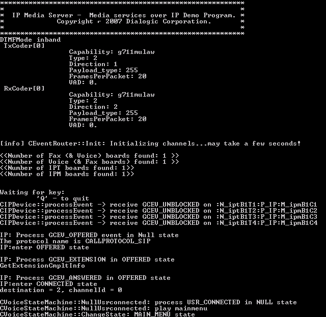

This is what I get when running IP Media Server and performa SIP call (attached mediaserver.png).
