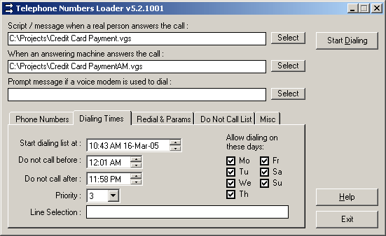

The Call Priority level can be set on the "Dialing Times" tab, and also specified using the iPriority field. From http://www.voiceguide.com/vghelp/html/DialListInto.htm :
iPriority
At what priority level the calls should be made. A lower number indicates a higher priority. ie: 1 is the highest priority, then 2 etc etc. Number of priority levels is unlimited.
And of course there is a field storing this priority level for each call inside the OutDial database...
