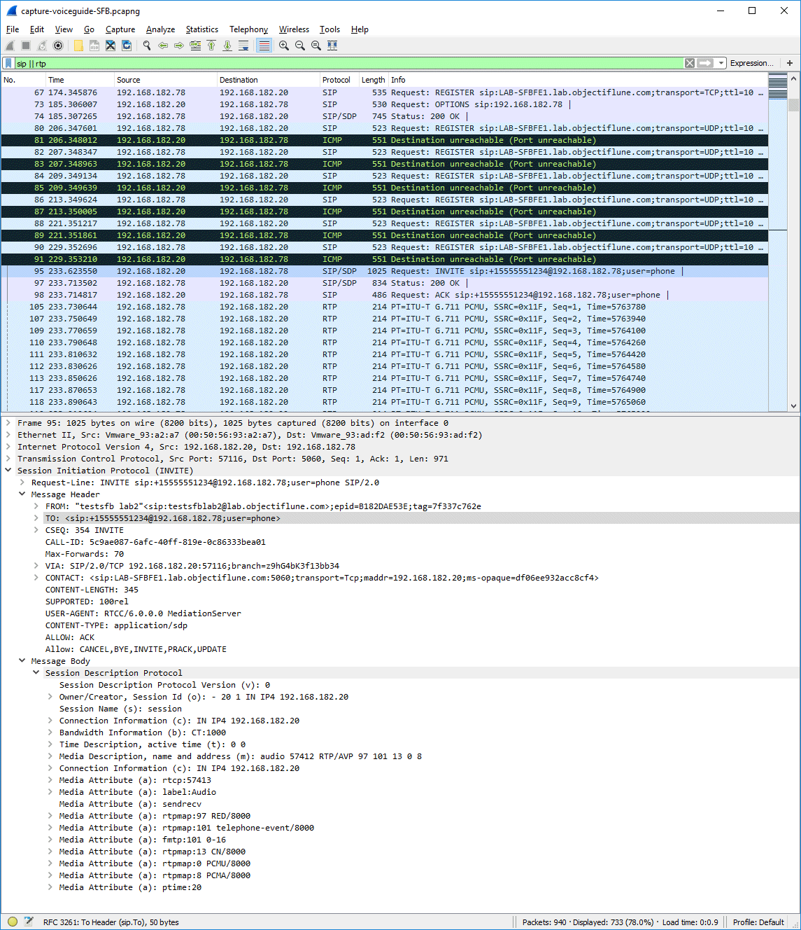

WireShark trace shows that VoiceGuide sytem is at IP 192.168.182.78, and the SIP server with which you are trying to communicate is at 192.168.182.20
What is the system at 192.168.182.20 ?
It is not responding to SIP REGISTER requests, and when VoiceGuide answers the call from it no voice data (RTP packets) is received from it.
See attached screenshot of your WireShark trace.

We can see SIP messages coming from SFB, and when SFB sends a SIP call to HMP/VoiceGuide we can see that that call is answered by HMP/VoiceGuide and SFB can see that that call was answered - and it relays the voice traffic from VoiceGuide to you - which you can then hear.
So your SFB is able to use SIP to establish calls.
Looks like there are some issues with voice data from SFB. No RTP packets can be seen from SFB. This should be resolved first. You may want to look at what firewalls are between SFB and HMP/VoiceGuide. Suggest disabling the firewalls temporarily and seeing if this resolves this.
