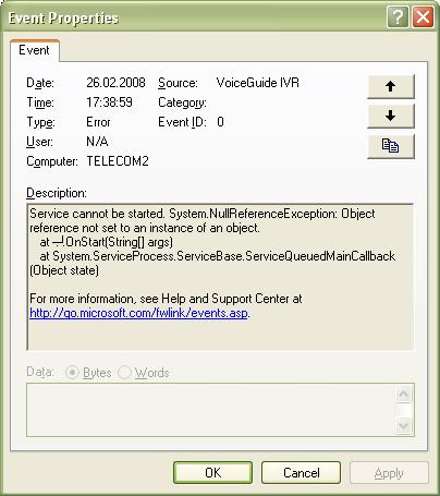

Then I installed Voiceguide 7.0.5 (trial) and in the end of process (window with "Finish" button), I got a message from debugger "An unhandled exception ('System.ArgumentException') occured in vgIvrService.exe". I tried to start Voiceguide service manually and got such an error.
I found two errors in Application Event log (Voiceguide event Log is empty) - in attachments

Did any logs get created in VG's \log\ subdirectory?
Please check if the Windows' Event Logs are set to "Overwrite if needed". This error can occur if the Event Logs are full and new information cannot be written into them.
There were no logs in \log\ subdirectory. Windows' Event Logs were set up to "Overwrite if needed".
