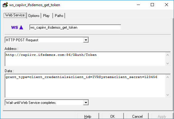

Here is how the web service at capiivr.ifsdemos.com would be used/consumed from VoiceGuide:
That web service first requires that an 'access_token' be obtained and then this access token is used when calling further APIs.
As per supplied document the access token is obtained by performing a HTTP POST to URL:
http://capiivr.ifsdemos.com:86/OAuth/Token
with the http message body set to:
grant_type=client_credentials&client_id=IVRSystem&client_secret=123456
The above is done using one 'Call Web Service' type module.
See screenshots below for module "ws_capiivr_ifsdemos_get_token". They show what setting were made to effect this POST request.
The web service returns a JSON formatted response, with one of the entries in that response being: "access_token"

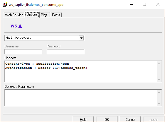

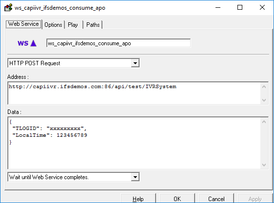

So now we use another 'Call Web Service' type module. (use a "on {sucess} goto ..."  type path to take script to next Call Web Service module)
The documentation provided specified to use this URL:
http://capiivr.ifsdemos.com:86/api/test/IVRSystem
and to make a HTTP POST request to above URL with this as the headers:
Content-Type : application/json
Authorization : Bearer $RV[access_token]
and with the http message body set (as per the documentation provided) to:
 "TLOGID": "xxxxxxxxx",
 "LocalTime": 123456789
See screenshots below for module "ws_capiivr_ifsdemos_consume_apo". They show what setting were made to effect this POST request.
The web service call results in this response being received back from web service:

and VoiceGuide then places entries in that response into $RVs that can be used later in the script.
Looking at vgEngine trace will show exactly what was returned and what  $RVs were created etc.

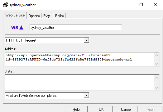

And regarding the question that was asked beforehand on how to consume the openweathermap.org web service:
I use this Web Service API http://samples.openw...2429c1c50c122a1, and it works for me. How can i get results and use this results to create sound file?
Here are the $RVs that are created when calling the XML version of the above API (using http://api.openweath...094aec&mode=xml ) :
Extract from vgEngine:
205458.765  24   5   1       rvns  add   sydney_weather_weatherdata_location_name|City of Sydney

#19 ThaoHuynh 18 April 2017 - 03:17 PM
Extract in vgEngine:
114726.019   9               rv    dbg   rv_retrieve did not find [ws_capiivr_ifsdemos_get_token_access_token]
How can i get access token and errorCode from ws_capiivr_ifsdemos_get_token_Result_Data?
114726.015  26   3   1       rv    add   ws_capiivr_ifsdemos_get_token_Result_Data|{"access_token":"516inOdJZYJwZOVF-u66G4NGB3H4Mi3OUOyGgjJlPV0hIx5kfvwsPXUHxJKS1X0j2Mt8G5bf3C1pYR0uJXK8EozA2c55QYP-yycIDUadiAjERmO8JOpByqToORF8v7FGkeohzf10yrG6JFyEWJBxbeEmECrWtfbnYaAHJiKU5WCW4Sll3gFNlD8ZOsDvGtzbAjZq58KnPJ-5-Qq2yayKFFJGIJDXg7qnvQ-T1LCYvZvDKhLY","token_type":"bearer","expires_in":1799,"refresh_token":"T74xsKvcojFirpfbVeI40QKIiJoeOb8qkx58vXTmAfEewUZJzRznOcaE2Q-N6ZVrpQlxlz-5Gixzk0MP8lz3glgvLbLQ79VXMlAUHZcwsEWN-9anC7dOcyt4ySQv7p1VoHhsuvZRqsM4kNTPHZNzSwkGhl71LsfrfS-_d8Ems3dp5d4axFMH6otofhMPEadAD-43Vpj7SRPS4HCv-MM0EBoFewZtIN2fQiMU9O9wH1wlgZ-t"
114726.354   9   3   1       rv    replace start [The result is $RV[ws_capiivr_ifsdemos_consume_apo_errorCode]]
114726.354   9               rv    dbg   rv_retrieve did not find [ws_capiivr_ifsdemos_consume_apo_errorCode]
#20 SupportTeam 18 April 2017 - 03:30 PM
Please try this in your version:
$RV[access_token]
#21 ThaoHuynh 18 April 2017 - 04:55 PM
I have tried and it worked for me.
How can i get errorCode from errorDetails?
134429.772  27   3   1       rv    add   errorDetails|[
    "errorCode": "00",
    "errorDescription": "Authorised / Passed"
134429.773  27   3   1       rv    add   ws_capiivr_ifsdemos_consume_apo_Result_Data|{ "tlogid":null, "errorDetails":[ { "errorCode":"00", "errorDescription":"Authorised / Passed"
#22 SupportTeam 20 April 2017 - 02:25 PM
Please update your system to this version:
[old link removed]
To change from one release of VoiceGuide v7 to another:
1. Stop VoiceGuide Service and exit all VoiceGuide programs. (eg Script Designer, Voicemail Manager, etc) and all other programs.
2. Run the VoiceGuide install and install into same directory as existing installation. (Do NOT uninstall the previous VoiceGuide installation).
3. Start  VoiceGuide service.
Running a VoiceGuide install over the top of an existing install will NOT overwrite existing configuration or license files (Config.xml, ConfigLine.xml, VG.INI, VmBoxList.xml, etc) and will not remove any of users script or sound files, and will not remove any log files etc.
This new version handles more complicated JSON responses better.
Previous versions only saves 'top' layer objects into own $RVs - and remainder needing to be parsed out (eg. using VBScript modules)
This version assigns an $RV to each response entry, with the $RV name consisting of module name and a 'JSON Path' to the response entry.
It performs similarly with XML responses, with the $RV name consisting of module name and the 'XPath' to the response entry.
Was not able to test directly against your API as it appears not to respond at this time.
Looking at vgEngine traces you should see the Result Variables which are created when the JSON response arrives from the Web Service.
The JSON response:
    "errorCode": "00",
should result in these two $RVs being created:
$RV[ModuleTitle_errorCode]
$RV[ModuleTitle_errorDescription]
Please try using new version with your API and please post traces as before if you still encounter any issues.
Here are the $RVs that are created when calling the JSON version of the Openweather API ( http://api.openweath...5e7628d83094aec) :
