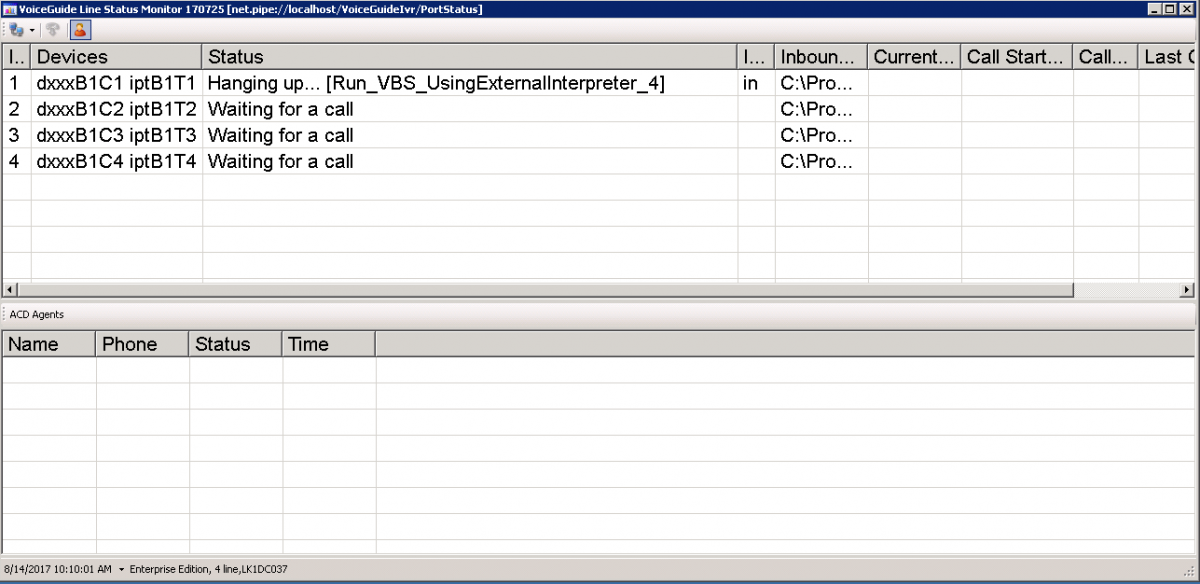

kindly note am try to run a VBS which is defined in y VGS file but am facing the issue in the attached image.
Please advise.

#12 ahmed.muneer 14 August 2017 - 05:13 PM
Dears ,
in the line status monitor there is a message appears about External VBS before line hang up , kindly check the attached image.

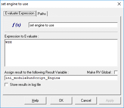

#13 SupportTeam 14 August 2017 - 07:18 PM
Looks like there is a bug in how the VBScript module is ran in the VoIP version of the current release.
Below can be used for now as a workaround:
Add a module that sets the engine to be used in script. This can be done by using an Evaluate Expressions module to set the Result Variable  $RV[ini_moduleRunScript_Engine] to a value of WSH
Please see attached screenshot.
Also attached is your script with that module added.
Please update your system with this change and try running again.
We should release a new version of software with this bug fixed soon.
