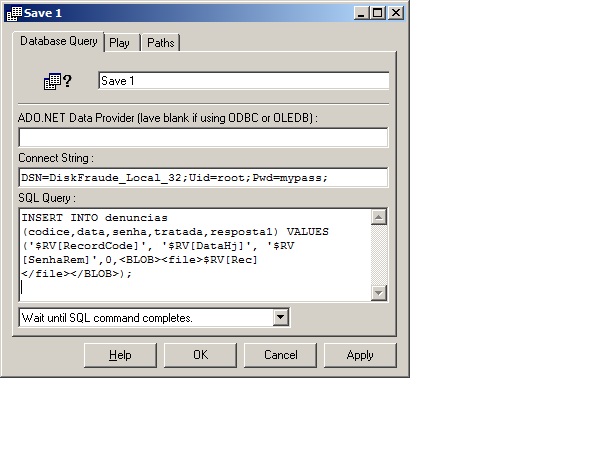

I tried to put serveral kinds of "Connect Strings", being (in the order) the following:
DSN=MyDSNConnect_32
ODBC;DSN=MyDSNConnect_32;
ODBC;DSN=MyDSNConnect_32;UID=root;PWD=mypass;
In no case I could connect with my DB. Tha last message (I can fin in VGEngine log) is that: "DSN not specified, using a DSN-less ODBC connection".
So my question is. Which is the correct "Connection String" in case I use MySQL ODBC, and I have a 32 DSN correctly set up using 32 bit ODBC driver ?? The funny thing is that the vbscript module can see (and now works fine) the DSNs without problems and works with it.

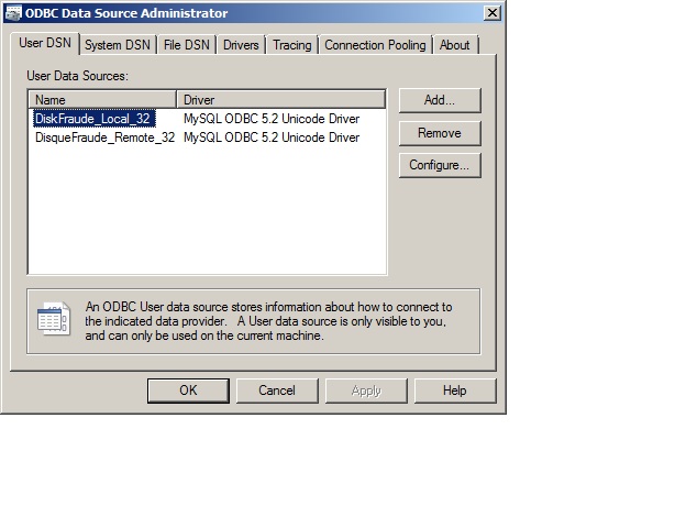

Is the DSN set up as a "User DSN" or "System or File DSN" ?
Can you please try setting up the DSNs under both User and System/File types, and have both types set up in both 32 bit and 64 bit ODBC managers.
It was as User DNS. Now I set up also as System DNS (with same DSN name, thus I 32 bit user DSN and 32 bit system DSN with same name). Still gives some error ... attached please find new VGEngine, now with both DSN enabled.
0312_1840_vgEngine.zip

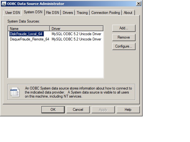

Sorry I've seen now that you required to set up also 64 bit ODBC DNS ... this I did not do. Is it necessary taking in account that Voiceguide is a 32 bit app ?
Attached screen capture of my 32bit and 64bit ODBC Administrators ... with list of enabled DSN.
The 32 bit one was run starting from syswow64 directory. The 64 bit one was started from admin tools menu.
Hope this will be useful.

We will look further into use of BLOB with ODBC/MySQL and advise.
Looks like BLOB inserts/retrieval is only supported when connecting to databases using ADO.NET Data Providers.
Please connect to your database using the ADO.NET Data Provider and you should then be able to insert and retrieve BLOB data.
Sirs, I need to observe that the line you mentioned (which I also noted) is using and reporting an ODBC driver which is not installed in my system (MySQL ODBC 5.2(w)) ... and this is a safe way to get an error. On my system I just have ODBC 5.2 Unicode (which is newer, I was using ver. 5.2w last year). Furthermore it seems to me that the log still reports the message "DSN not specified, using a DSN-less ODBC connection." which let me suppose that it is still not finding DSN, for some unknown reason. Anyway I'
All database connections made in both uploaded traces connect using the DSN and through the Windows' ODBC system.
The log entry that you mention is misleading in this case. We will have this log entry modified in future releases.

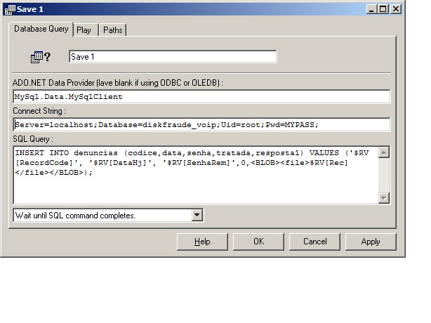

OK ... Then I downloaded (from mysql site) and installed the last version of .net connector (I did not have it installed since was just using ODBC). I changed the connection configuration of my DB Query module (see image attached) in order to use ADO according to the instructions in your help page, I saved the new script and turned on VG IVR. I called using linphone with direct IP (it's my way to test the script) ... and still not working. The log says something about a mysql syntax error ... which I can not find (my Insert is taked exactly from your help examples).
Attached please find the image of my new DB Query module and the new VGEngine log file, now using ADO.NET ...
0312_2255_vgEngine.zip
Trace shows that Result Variable $RV[Rec] is not defined.
From looking at the call it looks like the recording's filename was saved in $RV[Resposta 1]
So the SQL should be:
INSERT INTO denuncias (codice,data,senha,tratada,resposta1) VALUES ('$RV[RecordCode]', '$RV[DataHj]', '$RV[senhaRem]',0,<BLOB><file>$RV[Resposta 1]</file></BLOB>);
Please try using that SQL and if you still experience problems with BLOB insert please start a new thread on that topic and post associated vgEngine trace files.
