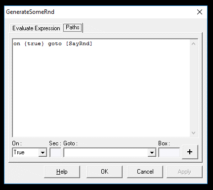

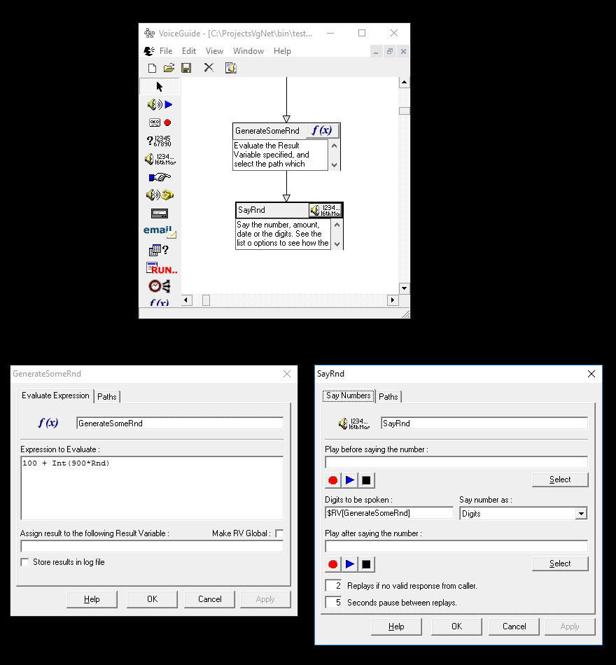

#4 SupportTeam 11 July 2017 - 09:41 PM
Use an 'Evaluate Expression' type module to evaluate this expression:
100 + Int(900*Rnd)
this will result in random number between 100 and 999.
The random number will be saved in $RV with the same name as the title of the Evaluate Expression module.
The $RV can then be used in a 'Say Numbers' type module to speak out the digits.
Use a Success or True path to go from the 'Evaluate Expression' type module to the 'Say Numbers' type module.
see vgEngine trace excerpt of a script doing this:
'Evaluate Expression' module was titled: GenerateSomeRnd
It created $RV[GenerateSomeRnd] that held the random number value, and the $RV[GenerateSomeRnd] was then played out by the Say Numbers module:

#5 SupportTeam 11 July 2017 - 09:49 PM
Also see attached screenshot :
