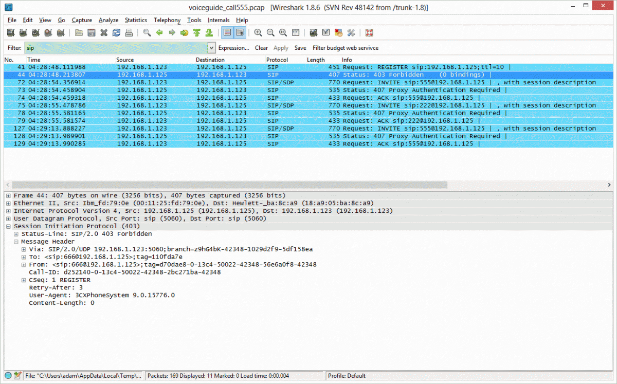

In this case the SIP registration did not work
the previous SIP register at 12:24:36 was fine, but SIP register at 12:28:48 returned "403 - Forbidden" from the PBX :

150 122848.240  6584           GCEV_SERVICERESP ResultInfo: gcValue=1286(0x506|GCRV_CCLIBSPECIFIC|event caused by cclib specific failure) gcMsg=[Event caused by call control library specific failure] ccLibId=8 ccLibName=[GC_H3R_LIB] ccValue=[0x151b||] ccMsg=[IPEC_SIPReasonStatus403Forbidden] additionalinfo=[]
151 122848.240  6584           ccValue!=IPERR_OK (VoIPProvider_AuthenticationSet)

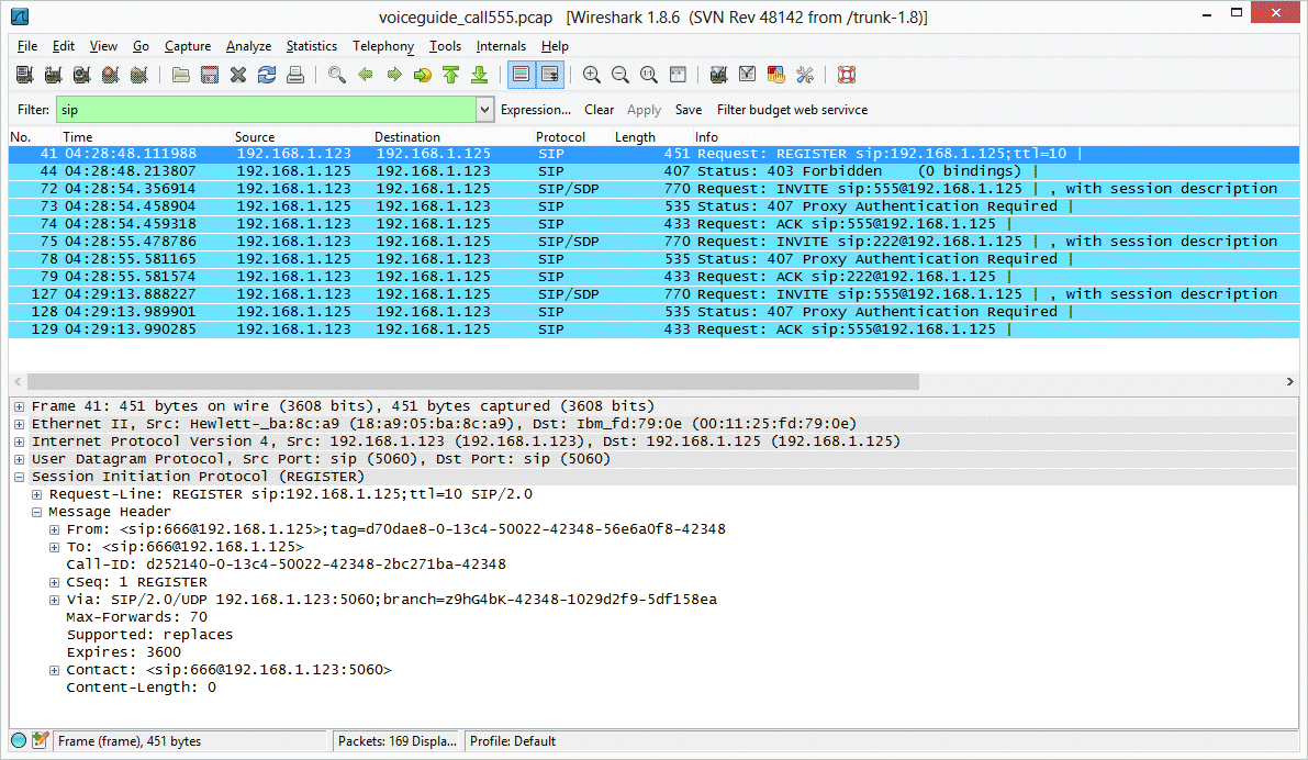

you can see that PBX returned 403 in the WireShark trace as well. See attached WireShark screenshot.
You would need to check 3CX logs to determine why 3CX decided to respond to a REGISTER request with 403.

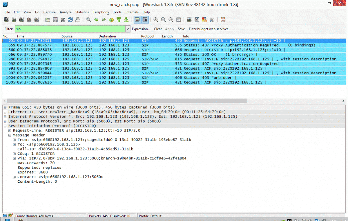

First you need to get the SIP Registration working again.
WireShark shows that HMP/VoiceGuide is sending exactly the same REGISTER request to 3CX but in last trace 3CX replies with "403 - Forbidden", whereas before 3CX replied with 407 and then HMP resent the REGISTER with authentication included and that was accepted OK by 3CX.
Has anything changed on 3CX ?
Are you able to see from any 3CX logs as to why 3CX is replying with "403 - Forbidden" ?
