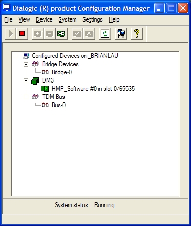

Here is the screen cap. of Dialogic Configuration Manager
I am using WindowsXP sp3, Intel Core 2 CPU
