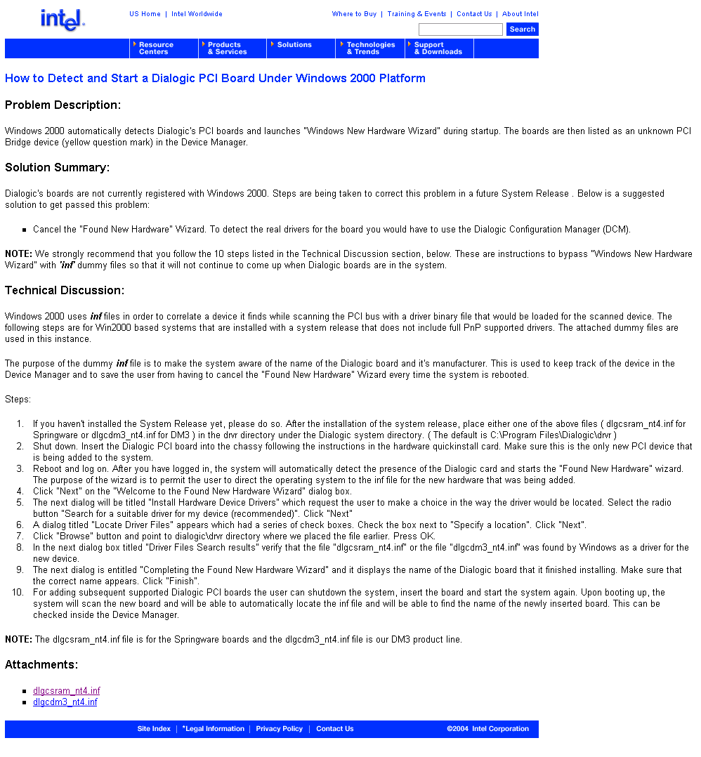

http://resource.inte...winnt/tn383.htm

#5 Guest_Bob_*
Posted 18 February 2004 - 12:59 PM
I got this message "Windows was unable to locate a driver for this device"
Steps:
If you haven't installed the System Release yet, please do so. After the installation of the system release, place either one of the above files ( dlgcsram_nt4.inf for Springware or dlgcdm3_nt4.inf for DM3 ) in the drvr directory under the Dialogic system directory. ( The default is C:\Program Files\Dialogic\drvr )
Shut down. Insert the Dialogic PCI board into the chassy following the instructions in the hardware quickinstall card. Make sure this is the only new PCI device that is being added to the system.
Reboot and log on. After you have logged in, the system will automatically detect the presence of the Dialogic card and starts the "Found New Hardware" wizard. The purpose of the wizard is to permit the user to direct the operating system to the inf file for the new hardware that was being added.
Click "Next" on the "Welcome to the Found New Hardware Wizard" dialog box.
The next dialog will be titled "Install Hardware Device Drivers" which request the user to make a choice in the way the driver would be located. Select the radio button "Search for a suitable driver for my device (recommended)". Click "Next"
A dialog titled "Locate Driver Files" appears which had a series of check boxes. Check the box next to "Specify a location". Click "Next".
Click "Browse" button and point to dialogic\drvr directory where we placed the file earlier. Press OK.
In the next dialog box titled "Driver Files Search results" verify that the file "dlgcsram_nt4.inf" or the file "dlgcdm3_nt4.inf" was found by Windows as a driver for the new device.
