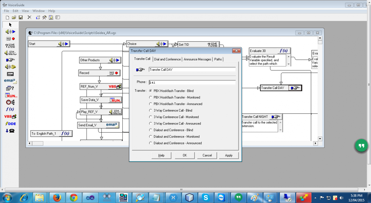

I have AVAYA system its connecting with IVR using Voiceguide but I am not able to transfer the calles.
What to do to transfer the calls??

#7 Muayyad_Idily 14 April 2015 - 12:15 AM
Thanks...
Now its working with me  :)
I used:
"PBX Hookflash Transfer - Monitored "
Also I changed Config.xml file for parameter (DXBD_FLASHTM) to 50
