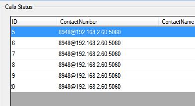

#3 Diego Miņo 29 April 2015 - 04:02 AM
Ready, enter the inbound calls correctly.
But how I can make the Outbound call?
My PBX is ALCATEL OXE
How I place the number to dial?

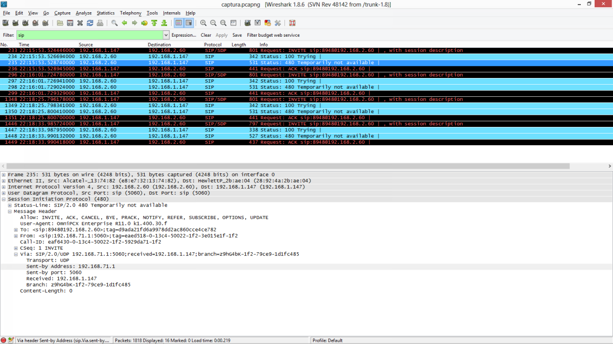

#6 SupportTeam 29 April 2015 - 09:39 AM
WireShark trace shows that the SIP switch at 192.168.2.60 (OmniPCX Enterprise R11.0 k1.400.30.f) replies with "480 Temporarily not available'.
You would need to look at the OmniPCX logs to establish why it chooses to answer an incoming INVITE with a 480.
Have you tried dialing extension 8948 from another extension on this PBX to confirm that 8948 works and calls to it can be answered?
Have you tried getting VoiceGuide to dial a different extension?
Also, can you please capture the WireShark trace of a call sent from OmniPCX to VoiceGuide (we can see that those calls are answered OK by VoiceGuide). We will then be able to see how the OmniPCX sends calls and that may shed some light on the problem.

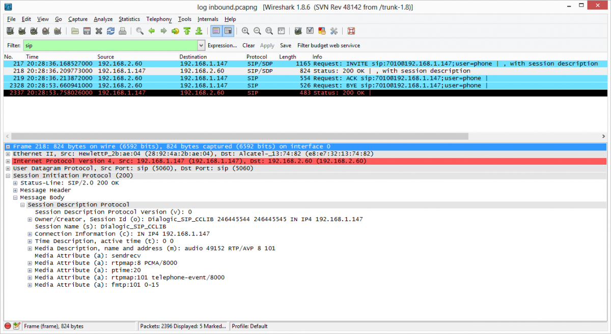

#8 SupportTeam 30 April 2015 - 07:12 AM
Incoming call looks fine; pretty standard SIP with A-Law encoding used for the voice traffic.
Have you done the tests on the 8948 extension as advised previously or tried dialing a different extension?

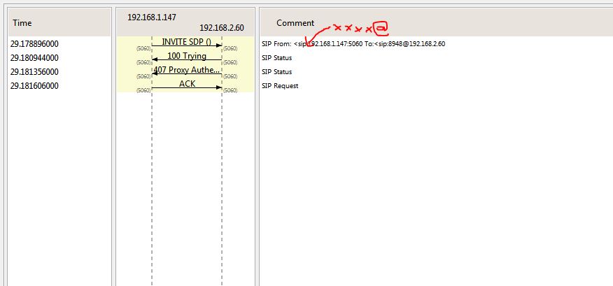

#10 SupportTeam 30 April 2015 - 10:04 AM
Look like PBX is requesting Registration/Authentication in order to proceed with outgoing call.
Do you have the user and/or password information required to authenticate outgoing calls through your PBX?
Information on configuring Registration/Authentication in VoiceGuide is here:
http://www.voiceguid...ip_register.htm
Can you please post the actual .pcap trace file from WireShark (.ZIPed).
The .pcap trace file contains the information that would need to see to confirm what you need to specify in VoiceGuide's Config.xml

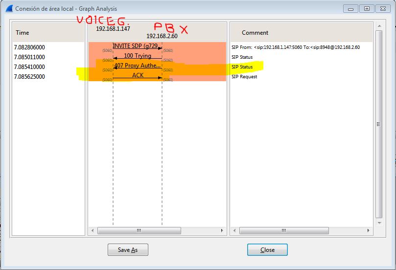

#11 Diego Miņo 01 May 2015 - 12:22 AM
Hello, the PBX does not require Registration / Authentication,
the logs are attached, and config.xml and wireshark

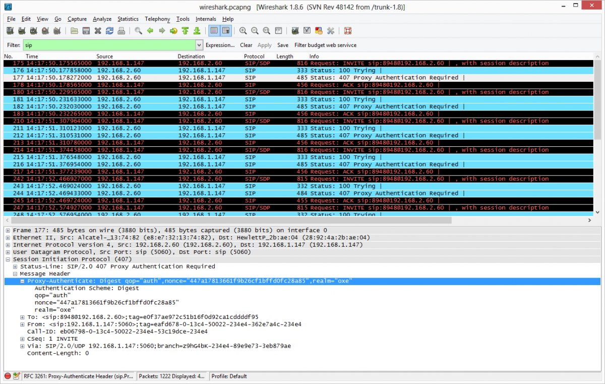

#12 SupportTeam 01 May 2015 - 07:42 AM
The PBX is answering the INVITE request with a "407 Authentication Required". Both the screenshot you supplied yesterday and the traces supplied today show this. (today's trace screenshot attached as well).
Digest Authentication asked for in the 407 message shows realm="oxe" and the nonce is provided, so it is a valid 407.
You would need to to check with OmniPCX admin as to why the OmniPCX is sending the 407 message and what are the Authentication details that re required by the OmniPCX.
