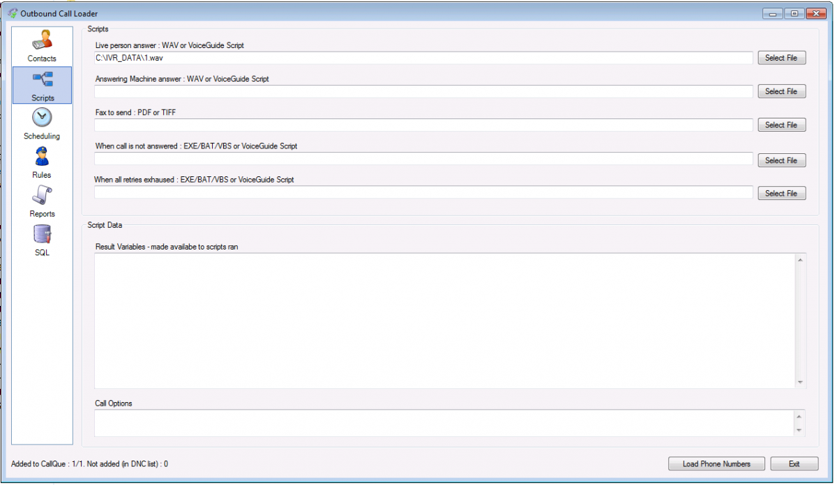

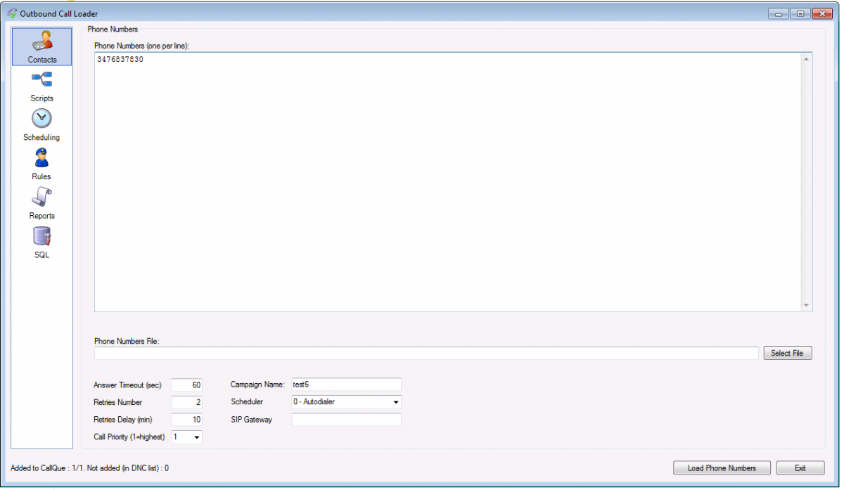

#19 yona 11 August 2015 - 06:56 AM
I've done as instructed to place outgoing calls, however, as you can see in the outbound call loader logs below, the call never went through:
following are pics of steps I've taken:
line status - https://gyazo.com/83...f910ad40ef92cfc
Contacts - https://gyazo.com/1b...a8b282ad383f2e2
Scripts - https://gyazo.com/70...f74c81fd5b66ca5
Scheduling- https://gyazo.com/2b...bdf63e2f2cc7010
Rules - https://gyazo.com/a9...7e1700bb242c88e

#20 SupportTeam 11 August 2015 - 08:03 AM
The number to dial has to be:
1498@74.208.110.16
not
3476837830
If you are trying to dial 3476837830 though the 3CX system then that number should  loaded in as :
3476837830@74.208.110.16
or
13476837830@74.208.110.16
Also, for outgoing calls you will need to specify through which registered account that call is to be made, so you need to specify the CallerID.
in the Options text box (at the bottom of the 'Scripts' tab) please include a Caller ID specification, like this:
<CallerID>1198@74.208.110.16</CallerID>
Attaching your screenshots below:
#21 yona 12 August 2015 - 03:37 AM
I tried the following but the call still didn't go through.
(I tried these 2 legitimate phone #s before trying the 1498@74.208.110.16 that you gave me to see if the call goes through at all.)
Screenshots of how it was set up:
Contacts: https://gyazo.com/65...6853691d14642c8
Scripts: https://gyazo.com/3c...7a88ca6fabff499
Scheduling: https://gyazo.com/06...ccb401ffc04fed7
Rules: https://gyazo.com/af...7aedd11d680f34b
Reports: https://gyazo.com/6c...8f9281020e2960c
SQL: https://gyazo.com/bf...e981fc1f235d279
Attached are also the ivr log files.
