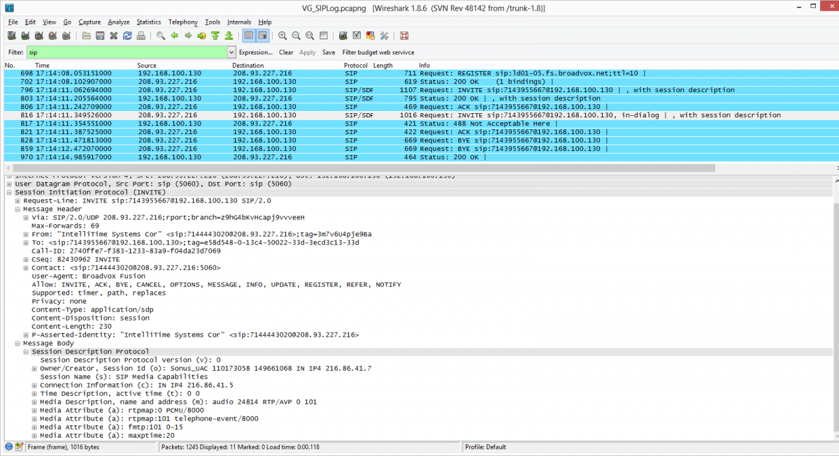

OK, I prepared the Wireshark log and attached here.
I can see "488 Not Acceptable Here" message, but please keep in mind that the connection to our VoIP provider was fine until I had applied the latest VG yesterday.
Thank you for your help again.

WireShark trace shows that HMP answers incoming fine, but then the device sending the call to HMP (Sonus / Broadvox Fusion) the sends a re-INVITE, and HMP responds to that re-INVITE with a "488 Not Acceptable Here" message.
Sonus / Broadvox Fusion then sends a BYE message to HMP to end the call.
Not sure why HMP would respond to the second INVITE message (the re-INVITE message) with a 488. This needs to be taken up with Dialogic (usually done through the HMP license supplier).
Quickest resolution may be to speak to SIP service provider and ask them to stop sending the re-INVITE.
