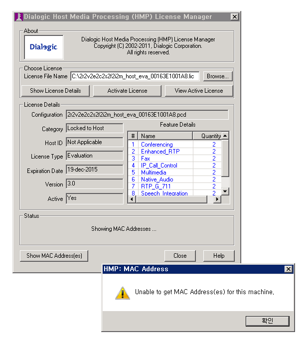

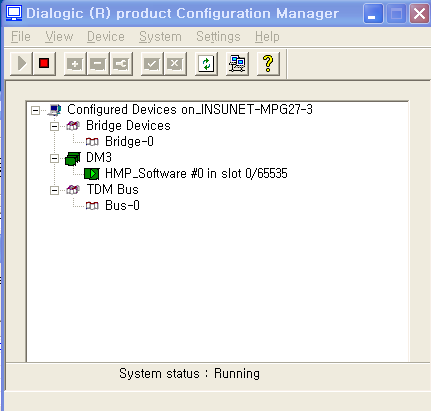

I got Dialogic trial license key.
I installed on my server.
But It doesn't work.
I attached images and log file.
please help me!
#2 SupportTeam 05 November 2015 - 02:36 PM
Can you please advise which version of Windows you are using and which version of Dialogic HMP drivers.
Are you using a physical machine or is this a virtual machine setup? If virtual then are you using VmWare or some other virtualization manager?
#3 leedalwoo 05 November 2015 - 02:43 PM
1. SQL SERVER 2008 R2 64bit
2. DialogicHMP30 Drivers for Voiceguide 7.5
3. Vmware Virtual Server

#8 SupportTeam 05 November 2015 - 03:19 PM
We don't recommend installing on any virtual machine provided by a 'cloud provider'.
Our recommended install is on a dedicated machine. Alternatively a VM from a VmWare ESXi 5.x on your own server,
