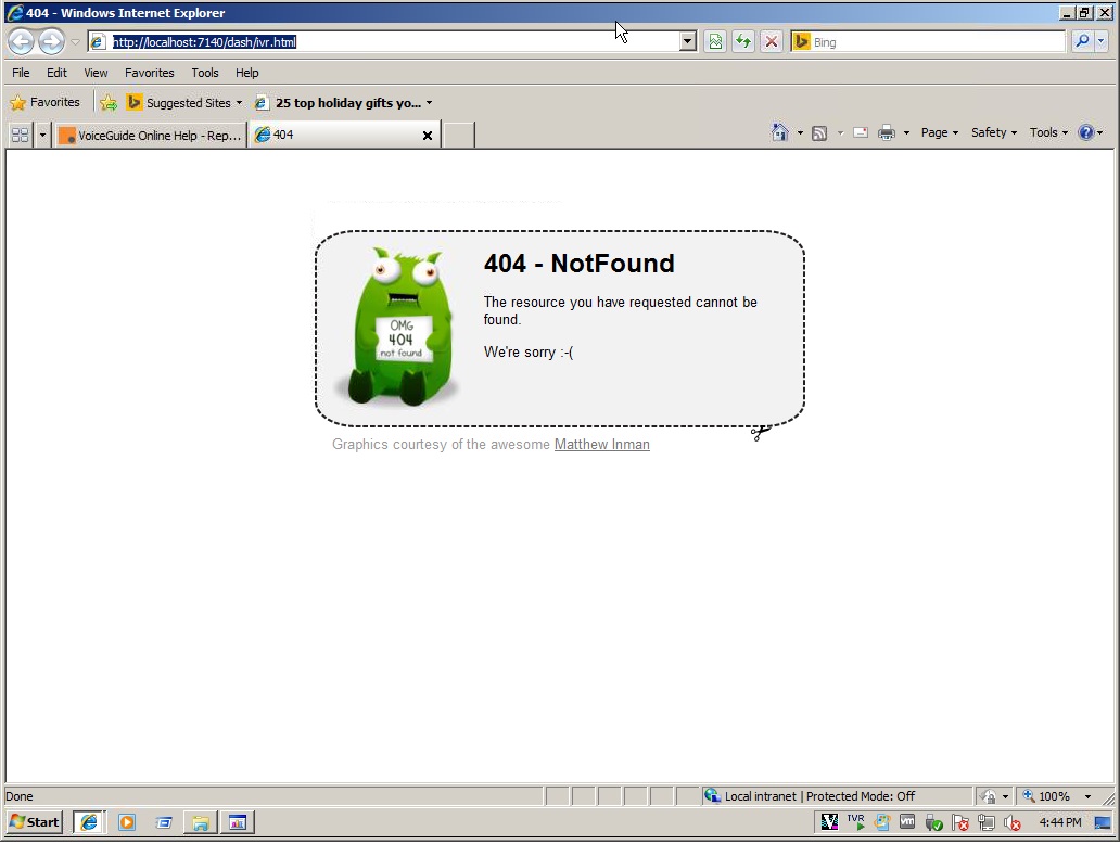

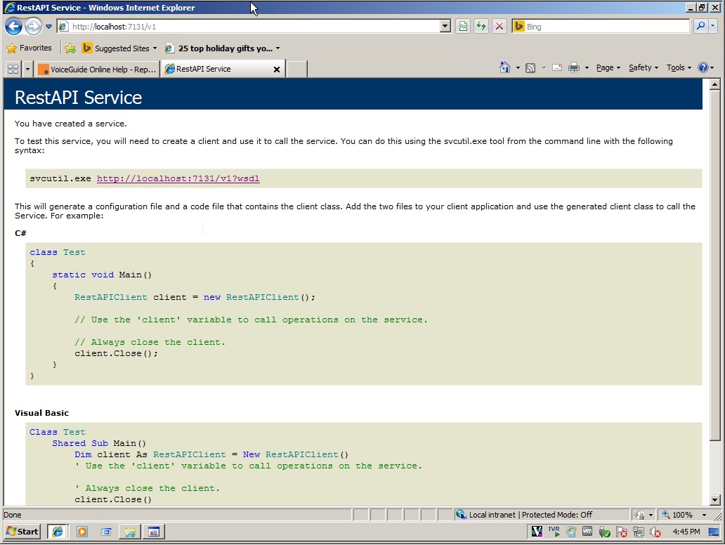

I have installed and running the VG7 with Dialer but I can not access the Dashboard either locally or remotely.
However I can access to the REST API locally and remotely.
Any suggestions?

The version used on this system is not the latest v7.5, and the dashboards are at a different address in that earlier version.
Please try
http://localhost:7140/dash_ivr_basic.html
or update system to latest version of VoiceGuide.
When installing: make sure to stop VoiceGuide service and exit all apps before running over the top of existing installation (do NOT uninstall beforehand - uninstalling will delete the config files)
