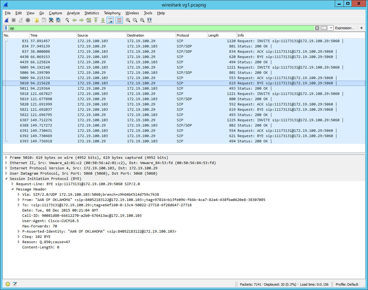

#5 SupportTeam 08 December 2015 - 04:22 PM
WireShark shows 1st call is fine, with caller hanging up about 30 seconds after call began.
Calls 2, 3 and 4 are hung up by the CISCO device immediately after it acknowledges that it has received the OK from VoiceGuide that VoiceGuide sends to say that it has answered the call.
On calls 2, 3 and 4 the Q.850 cause sent by Cisco at disconnect time is "47", which usually indicates some sort of a "Resource Unavailable" error.
So looks like there is some issue with this Cisco CUCM setup that results in Cisco disconnecting the call.
