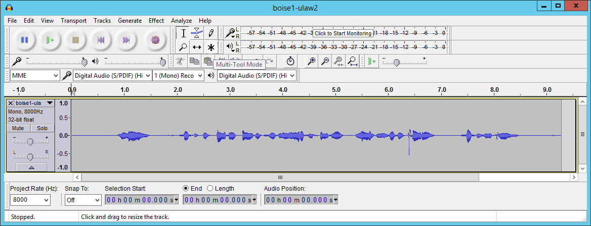

#5 SupportTeam 09 March 2017 - 09:12 AM
The boise1-ulaw2.wav file is in correct format (u-Law 8 kHz, 8 Bit, Mono), but it is a bit too quiet and has silence at beginning and end. See the screenshot below:
The amplitude of recording is small and boise1-ulaw2.wav sound file has close to 1 second of silence at beginning and end.
That 1 second of silence will add to the delay before & after the actual speech is played out over the phone connection.
Compare this to any of the sound files that come with VoiceGuide:
Recommend re-recording to get a sound recording that is not too quiet, and after recording removing any silence from beginning and end of sound file.

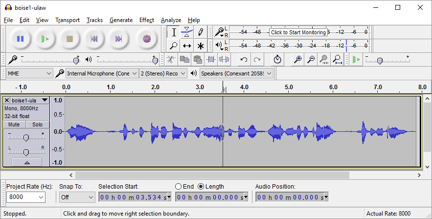

#7 ID2016 10 March 2017 - 07:05 AM
Do I just need to find somewhere the copy of vgDialListLoad.exe of he correct version and copy over?
I know that no rollback was done on this server, not as I am aware of it. What should be my approach? Or reinstall it from scratch.
Also can you please check the wav file to see if this is good to use.
Thank you!Attached File  boise1-ulaw.wav   68.75KB   38 downloads

Opening the attached wave file in Audacity (see: http://www.audacityteam.org/ ) shows that the leading and trailing silence has been removed, but the file is still quiet. For best recordings the loudest parts of the sound recording should take up the entire volume range

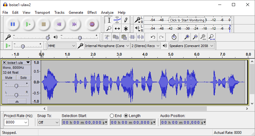

#9 ID2016 11 March 2017 - 01:54 AM
Thank you!
Please check this recording....
Thanks again!

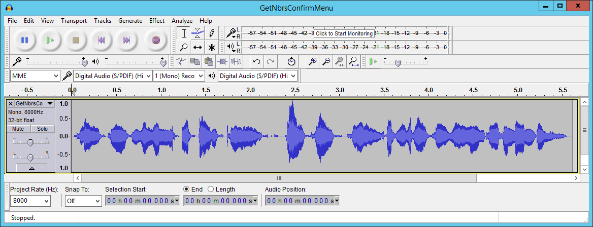

#10 SupportTeam 11 March 2017 - 06:05 AM
This looks better.
