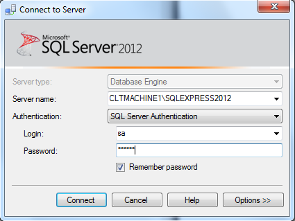

#7 ThaoHuynh 05 April 2017 - 02:02 PM
I have modified Config.xml. So SJPhone can call to VoiceGuide system, but i can't hear correct .wav file. And after that, voiceguide hang up automatically.
Why i failed login for user 'sa' while i can connect SQL server for user 'sa'?

#10 ThaoHuynh 05 April 2017 - 02:59 PM
My config.xml
<OutDialQue_ADODB_Provider>System.Data.SqlClient</OutDialQue_ADODB_Provider>
<OutDialQue_Database>PhoneBookDB</OutDialQue_Database>
<OutDialQue_ConnectString>Data Source=CLTMACHINE1\SQLEXPRESS2012;Database=PhoneBookDB;User ID=sa;Password=******;</OutDialQue_ConnectString>
<OutDialQue_PortToUse_LinkField></OutDialQue_PortToUse_LinkField>
<OutDialQue_SqlPrefix></OutDialQue_SqlPrefix>
<OutDialQue_SqlSuffix></OutDialQue_SqlSuffix>
In Query DB:
Data Source=CLTMACHINE1\SQLEXPRESS2012;Initial Catalog=PhoneBookDB;User ID=sa;Password=******;

#12 SupportTeam 05 April 2017 - 03:03 PM
Have you tried using "Initial Catalog=" instead of "Database=" in the Config.xml connection string?
#13 SupportTeam 05 April 2017 - 03:09 PM
