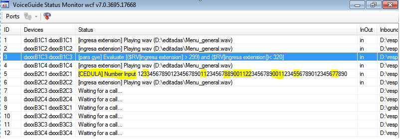

Hi, I have detected in clients that I have installed their IVR that repeats the entered digits.
I did an exercise by entering the digits 1234567890 in a row and repeating some.
How can I solve that problem? The dialogic are d41 and d120
The pbx is alcatel OXO and OXE gives me analogical extensions.
Attached image of online monitoring and logs.
Br
Diego Mino

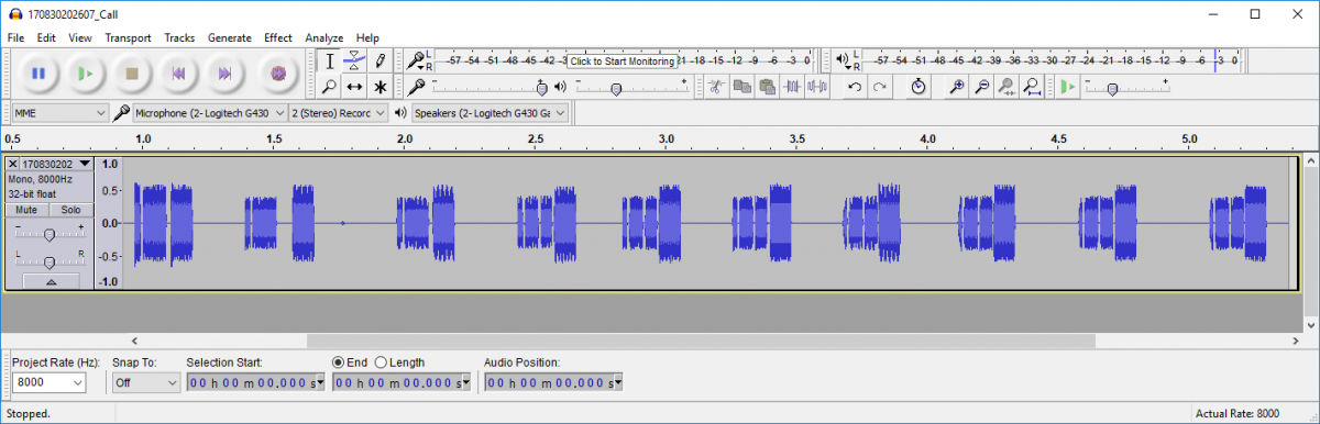

#4 SupportTeam 31 August 2017 - 01:47 PM
Looking at the recorded sound file (see attacehd screenshot) we can see that the DTMF tones are not received clearly.
There are gaps in the tone and volume differences as well.
Most received DTMFs  suffer from same type of problem.
You could change the "debounce" settings to stop the multiple DTMF detections, but best to resolve the cause of the problem.
Can you try using the record module to just record normal voice for say 5 seconds and then play that sound file back to the caller immediate after? Does the played back recording sound OK?

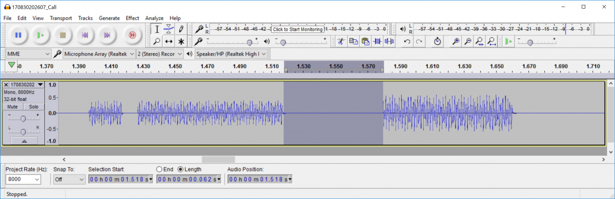

#8 SupportTeam 07 September 2017 - 06:56 AM
call of pbx extension dont have a problem.
If only external calls calls coming in over the external trunk are distorted then you should speak with the company that provides that external trunk.
Most likely the calls have at some stage within their network been carried over VoIP or similar packet switched system and that system has not been properly set up or is affected by packet delays/drops/etc.
As your recording shows: the DTMF tones are not carried properly through their network, and the DTMF tones sent through their network have silences within them.
From recording we can see that the silences in the re-generated tones are sometimes over 60ms ! (see attached screenshot of the 2nd tone in the recording) and as these silence-gap distortions differ from one DTMF tone to another then you may encounter even longer 'in-digit' silences.
This needs to be fixed by the Telco that is providing that trunk connection.
Have you contacted the provider of that trunk?
We can make the change to software to let it behave as per this:
We can add a option to VoiceGuide that will have the software ignore repeated DTMF tones if same tone arrives within say a quarter of a second, but that would then mean that callers who press the same number multiple times quickly may not have those key-presses recognized as multiple numbers.
please contact sales@voiceguide.com for a quote on getting this done.
