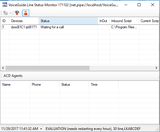

I have 8 channels of HMP on my system
but only one appears in the voiceguide line status monitor.
How do I tell voiceguide to use all 8 channels?
Config.xml is like this:

#2 SupportTeam 30 November 2017 - 06:11 AM
Please stop the VoiceGuide service, and stop the Dialogic HMP service, and then in the Dialogic Configuration Manager use the "Device -> Restore Defaults" Menu option to load the license settings.
Please see the "Applying Dialogic HMP License" section at end of this page: http://www.voiceguid...dialogichmp.htm
Then start the Dialogic service and then start the VoiceGudie service.
Also the 5th, 6th, 7th and 8th Voice devices are named: dxxxB2C1 to dxxxB2C4
So the entries 5 to 8 of the Config.xml should be:
