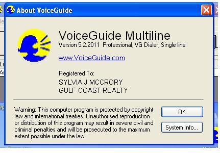

Sounds like you are running a licensed version of VoiceGuide that has only been licensed for one line...
Please post a screenshot of VG's 'About' window.

Once again, Thanks for the quick reply. I've attached the requested screen shot and it says Multiline Professional and dialer with one line.
My meager understanding is that this will handle multiple lines coming in but only be able to dial out with one. Is that correct?
Dialing out with one line is fine for our purpose, but we would like 2 lines coming in to be answered.
In looking at your various license types, it appears that 4 line Professional with one dial out line is one price, then 4 line Professional with 4 line dialer is another price. Again, I'm not real clear to which one I would have to have.
If I want 1-4 lines coming in, but only need one line dialing out, do I already have that version? If not, which one do I need?

You will need to purchase another Pro+Dialer license if you require another line to be controlled by VoiceGuide and have the dialer enabled on the 2 line system
You cannot have a '2 line Pro + 1 line Dialer' license.

I'm posting this 2 1/2 years after the above post. This thread will show you proof of ownership and you explained (after I posted the About Screen) why only one line worked. This was fine and all was well for 2 1/2 years.

Please help. My wife and I have a small real estate business as you can see by the above screen shot of our registration. We really need the services of your software returned to proper working order.
