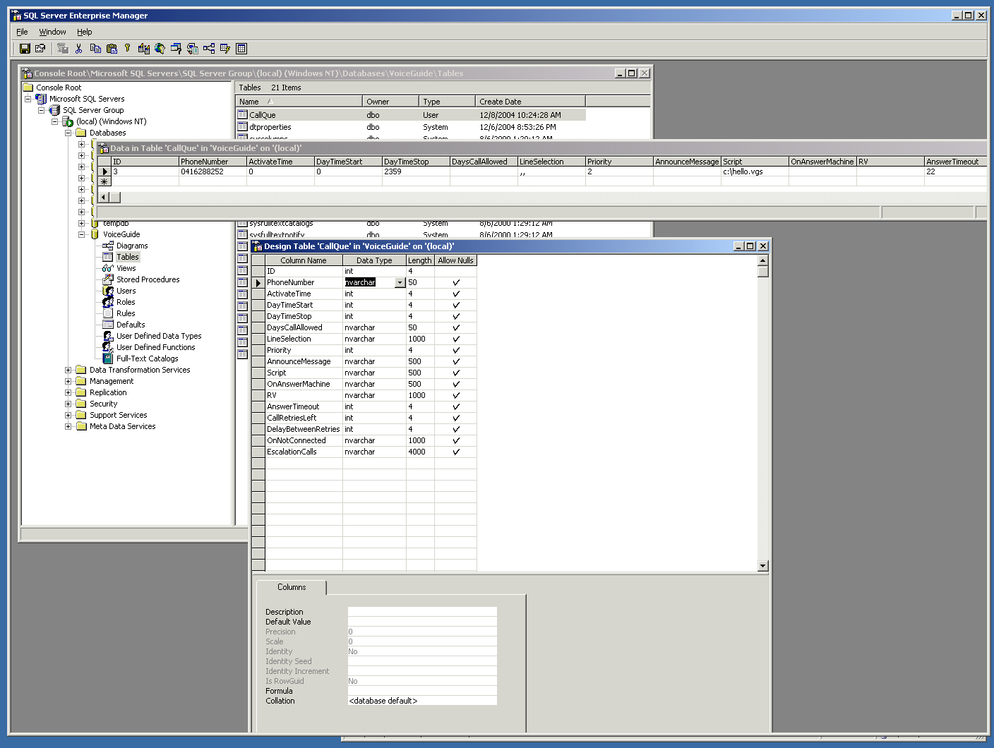

SupportTeam Report post Posted 04/07/2005 09:54 AM Add the connect string entry to VG.INI's [VGDialer] section. Entry name is "DbConnectString_ADO" one we use here is: DbConnectString_ADO=Provider=SQLOLEDB;Server=AQUA;UID=vg;PWD=vg;Datab ase=VoiceGuide I'm attaching a backup copy of the MSSQL database - (see the "VoiceGuide" database, table "CallQue") and a screenshot of the MSSQL config for relevant table. Any entries inserted into the MSSQL table will be picked up the same way as entries inserted into the MSAccess table. Table column names etc are the same. I think this should be enough to get you going - pleae post if you have any problems. Share this post Link to post

SupportTeam Report post Posted 04/19/2005 10:12 PM It will look in both. Just don't insert any entries into the .mdb database. Are you inserting entries directly into the MSSQL? The "Telephone Number Loader" app and the "Make Outbound Call" module will still use the .mdb Share this post Link to post
sbensen Report post Posted 04/20/2005 03:32 PM Yes, I tried inserting them directly and it still doesn't seem to grab them Share this post Link to post
