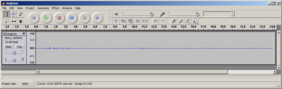

SupportTeam Report post Posted 05/22/2005 10:38 PM I have uploaded a wav file with the recording Please post the recording of the ringback tone. From post on May 21 2005, 11:16 AM : The ringback.wav file that you supplied contained just silence... how to use the audacity application You open the .WAV file in it and just ook at the timings of the ON/OFF tone... and the frequency spectrum is accessible via "View"->''Plot Spectrum" menu. Share this post Link to post
SupportTeam Report post Posted 05/22/2005 10:40 PM and the ringtone.wav you just posted at May 23 2005, 08:31 AM also contains just silence... Share this post Link to post
jacksors Report post Posted 05/23/2005 02:07 AM Not sure why the file isnt working for you, its worked on 4 indivdiaul pc's i've opened and played it on. Maybe you just need to increase the volume. Well I guess I would just need more information on the individual parts of the configline.xml components and what they mean so I know what to look for in the recordings and which numbers to pull out. Can you provide definitions of what each of these are and where to find the information in audacity? <Freq1>438</Freq1> <Freq1Dev>138</Freq1Dev> <Freq2>438</Freq2> <Freq2Dev>138</Freq2Dev> <On>130</On> <OnDev>105</OnDev> <Off>400</Off> <OffDev>200</OffDev> <Count>1</Count> Share this post Link to post
MannyTC Report post Posted 05/23/2005 05:04 AM Just to let you guys know, I downloaded the file and I can hear stuff. I did have to turn the volume WAY up. Share this post Link to post

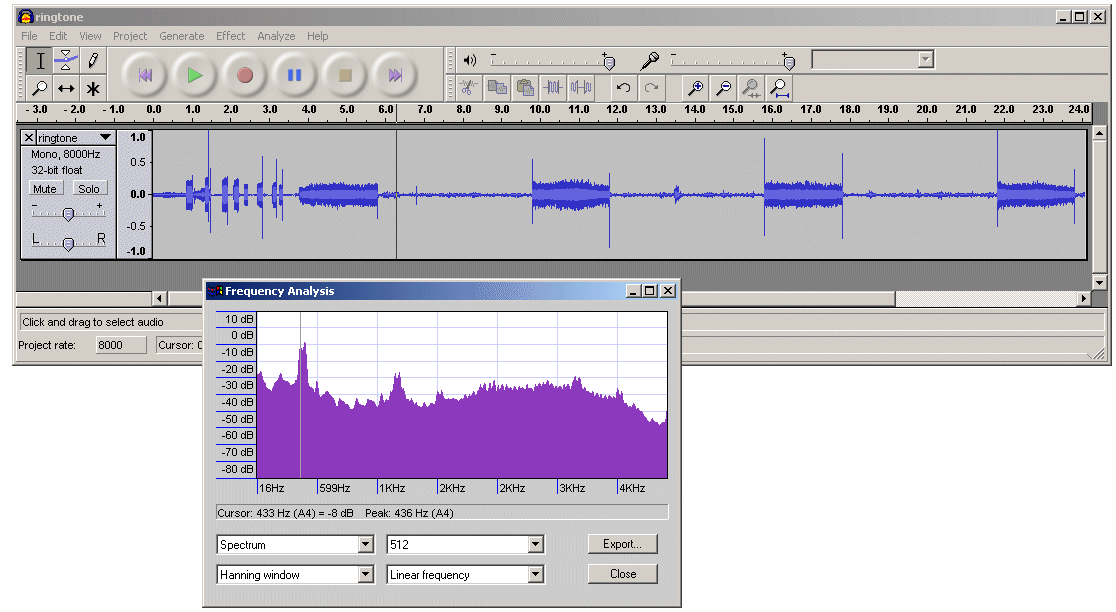

SupportTeam Report post Posted 05/23/2005 06:03 AM When we opened the supplied file in a sound file editor we saw: Share this post Link to post
SupportTeam Report post Posted 05/23/2005 06:08 AM Amplifying the sound file and then further just amplifying the ringback section of the file get the following wave form and the spectrum for the 1st ringback signal is as shown. The spectrum indicates that one is a dual frequency with two frequencies being 435Hz and 480Hz. These values may not be entirely correct due to poor quality of the initial recording. Share this post Link to post
SupportTeam Report post Posted 05/23/2005 06:20 AM The cadence of the ringback signal is 2 seconds on and 4 seconds off. Based on the supplied recording the settings for the TID_RNGBK1 entry in the ConfigLine.xml file should be: <Freq1>440</Freq1> <Freq1Dev>30</Freq1Dev> <Freq2>480</Freq2> <Freq2Dev>30</Freq2Dev> <On>200</On> <OnDev>20</OnDev> <Off>400</Off> <OffDev>40</OffDev> <Count>1</Count> Please try with these settings. If you still have problems please post the traces which captures the entire initialization stage when software starts as well as the outgoing call. (MMDDvgm.txt and MMDDtw.txt traces) Share this post Link to post

jacksors Report post Posted 05/23/2005 01:57 PM Ok, I made the modification to the configline.xml file. It seems like that may have had an impact. Based on what I saw from the log, it seems VG went down the timeout path. 091646.14 1 event TDX_CST, code=134, state=1903 091646.16 1 LsXfer_3_AfterDialDestNbrWaitForCallProgInfo 134,TDX_CST,200,0,0,DE_TONEON,TID_RNGBK2, 091655.89 1 timer fired EV_TIMEOUT_ANNOUNCED_TRANSFER_ATTEMPT_TOOK_TOO_LONG 091655.89 1 event EV_TIMEOUT_ANNOUNCED_TRANSFER_ATTEMPT_TOOK_TOO_LONG, code=9021, state=1903 091655.89 1 LsXfer_3_AfterDialDestNbrWaitForCallProgInfo 9021,EV_TIMEOUT_ANNOUNCED_TRANSFER_ATTEMPT_TOOK_TOO_LONG,0,0,0,,, 091655.91 1 Transfer timed out 091655.91 1 xfer dial !,,4 091700.53 1 tw PlayEnd 1 0 091700.53 1 play end id=0, (current ID) However when it did, it issued the PBX String command of , !,,4. However, this is the string command used to pick up a call when my PBX detects a busy signal. There is a different command used to pick up a call when no one answers(ie the phone just rings). I have brought this point up in just about every post I have made to this thread and have never receieved a response to this particular question. VG acts correctly when pickin up a call from a busy signal, nut not from a no answer(just a ring back). What I need to know is, can VG be modified so that it sends a different set of PBX strings when the dialed number is not answered (!,1) vs when the line is busy(!,,4)? If the answer is no, thats ok. I just need this question to finally be answered. Thankyou. Share this post Link to post
