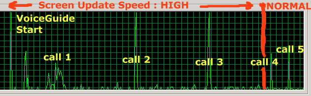

Here is a test of AT&T TTS I just did on a 866MHz PIII with 384MB RAM (a low end Compaq Deskpro EN).

On the very first call it did take 7 seconds to create the sound file and start playing it:
153501.69 7 [Play TTS test] Playing
153501.69 7 tts generate start[...]
153508.98 7 tts generate end
153508.98 7 [Play TTS test] Playing (none, C:\vg\system\tts7.wav)
but on the second and following calls it took less then one second to generate a 27 second sound file and start playing it:

attached is the screenshot showing the Performance Monitor trace of all calls.
For the first 3 calls the update speed was set to High, and for the last two calls the update speed was set to Normal - hence the difference in how the CPU usage spikes are shown.
