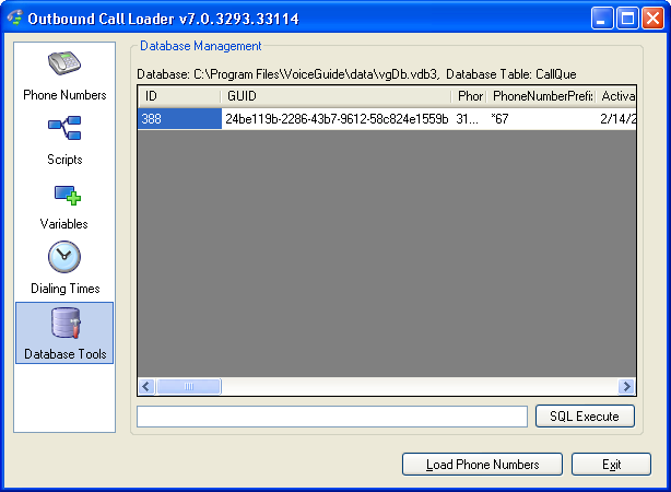

Guest u4910 Report post Posted 02/14/2009 11:26 PM OK, now I'm am dead in the water making any outbound calls, voice or fax. I can get inbound fine. The only thing I can think of is when I did a "delete from callque" in the phone number loader. I've attached a screen shot and log files. Please advise and thanks. 0214_1806_vgDialListLoad.txt 0214_1758_vgEngine.txt Share this post Link to post
Guest u4910 Report post Posted 02/15/2009 01:35 AM I noticed that the dialogic driver was having problems with something? I uninstalled the dialogic 6.0 rebooted reinstalled rebooted and vg still won't dial out. It will receive fine. Share this post Link to post
SupportTeam Report post Posted 02/15/2009 08:39 AM The outbound dialing related questions should really be placed in another thread as this not a fax related issue. "delete from callque" is not sufficient to delete all call information. If you are going to issue SQL statements to the database please familiarize yourself with the tables in the database first. More information on the table is also here: http://www.voiceguide.com/vghelp/source/ht...rnal_config.htm At this stage suggest you just stop VG and delete the database file: C:\Program Files\VoiceGuide\data\vgDb.vdb3 and then start VG again. VG will then recreate the database. Share this post Link to post
Guest u4910 Report post Posted 02/15/2009 12:14 PM That fixed my outbound issue after deleting callque. Thanks, I was desparate after vg trying to dial over and over. If that happens again I know what to do. Share this post Link to post
