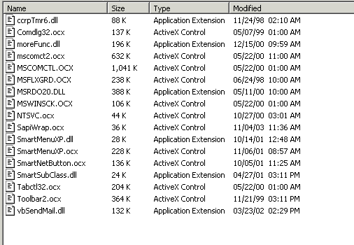

Not too sure which DLL/OCX is the problem here...
I'll attach a list of DLLs installed with VoiceGuide v5.1.4 into Windows' System32 directory - if your Window's System32 directory contains these DLLs but which have different size/date then please delete them and install VoiceGuide again.
If that does not help the only other approach I could recommend would be to re-install Windows and then install VG again...
