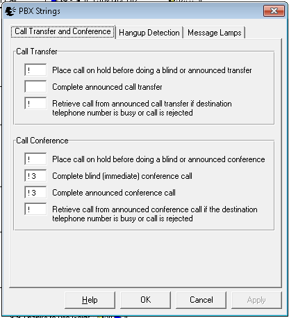

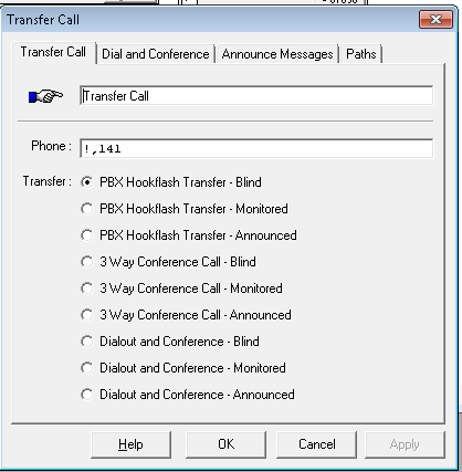

Muayyad_Idily Report post Posted 12/30/2013 10:17 AM Dear Sir, I have IP panasonic Central (KX-NCP 500 ), for that I used analog card ( 8 ports ) and I have dialogic D4PCI-U card I tried hook "!" but some time its working fine and most of the time the extension getting busy tone while transfer the call. What is the issue? Please find the setting made in VG (PBX Setting.png & transfer.png & hangup.png) its saying transfer to !141 but I am getting busy tone In that extension. Could you please help us to solve this issue as earliest. Regards , Muayyad 00966551166156 muayyad@geidea.net Share this post Link to post
SupportTeam Report post Posted 12/30/2013 12:18 PM It looks like you are using VoiceGuide v6. Do you know what hookflash length your PBX uses/expects? Please post the VoiceGuide config.xml file. Also please post the VoiceGuide traces capturing system startup and transfer attempt. In cases where the transfer fails can the original caller hear the DTMF tones of the destination extension being dialed? Share this post Link to post

SupportTeam Report post Posted 01/02/2014 12:09 PM from http://www.voiceguide.com/vghelp/source/html/config_calltransfers.htm : he hookflash length is set in Config.xml file, in the Parmeters_DxBd section. The following section of Config.xml should be edited: <Parmeters_DxBd> ... <Parmeter> <Description>Flash time during dialing (10ms units)</Description> <Key>DXBD_FLASHTM</Key> <Value>10</Value> <Default>10</Default></Parmeter> ... </Parmeters_DxBd> A setting of 10 means 100ms. The setting is in 10ms units. Recommend setting this entry to 20 and see if this results in more reliable hookflash transfers. The PCI card will work fine with VoiceGuide v7. Share this post Link to post
Muayyad_Idily Report post Posted 01/07/2014 06:54 AM Problem solved after change the parameter value to 20 and put the extension without hook flash character (!) Thanks for your support. Regards, Muayyad 00966551166156 muayyad@geidea.net Share this post Link to post
