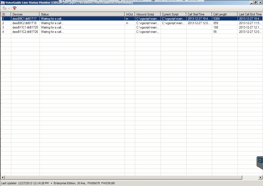

Hi Support Team,
I had attached along the screenshot to explain further what had happened to my VoiceGuide system.
Scenario:
From the attached screenshot, Channel ID 1 and 2 status showing "waiting for a call...", but the call direction shows "in" and the call lenght keep increasing non stop until I stop the VG service and restart again. This issue is very frequent here.
How can I prevent this from happening?
We would need to see the VoiceGuide traces (ktTel and VgEngine) to advise what is happening.
Also - looks like you only opened 4 channels of an E1 trunk. Please note that calls that Switch would send to Dialogic on other 26 channels would not be answered.

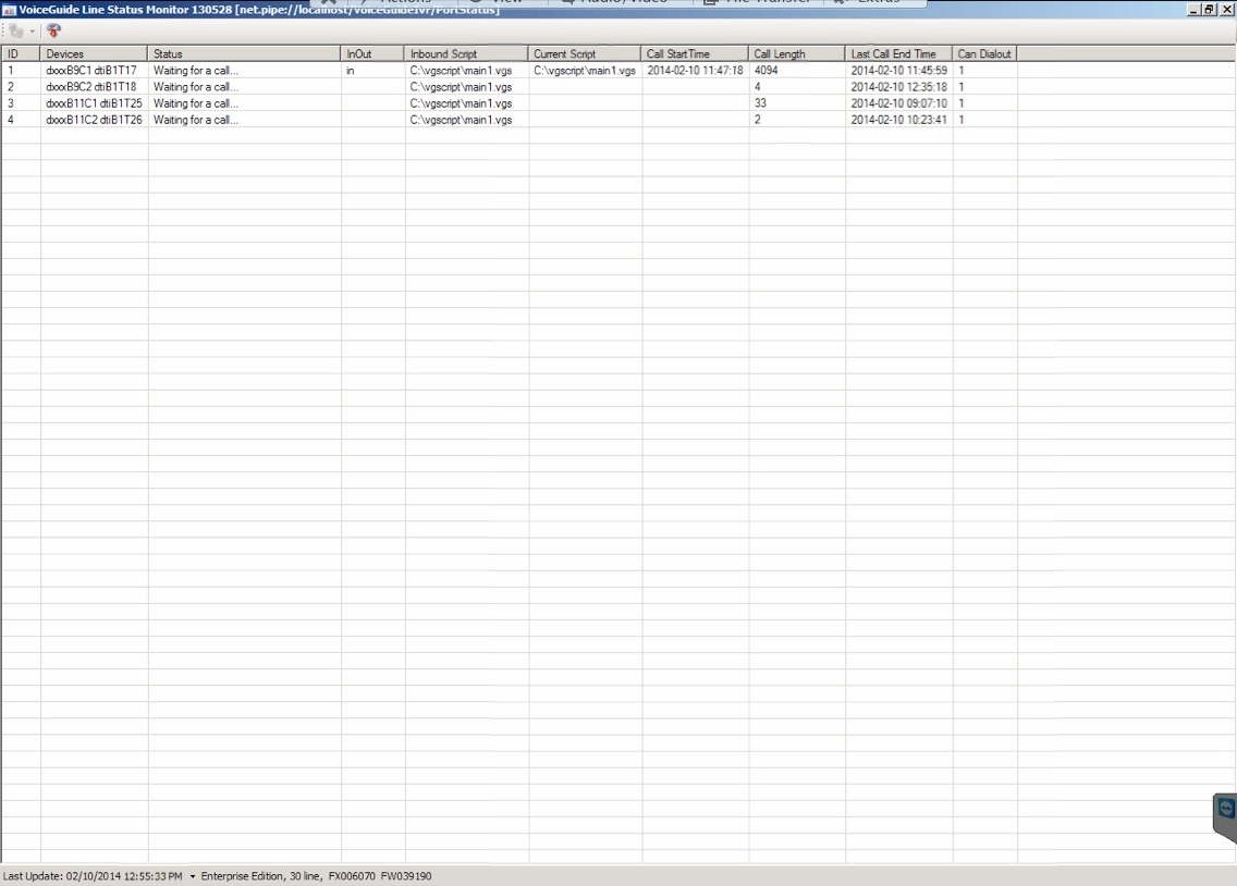

Hi Support Team,
Sorry for the late attached file. I had posted up the latest log files as requested which has the line hanged. Kindly let me know what's wrong with the channel.
Thank you!
