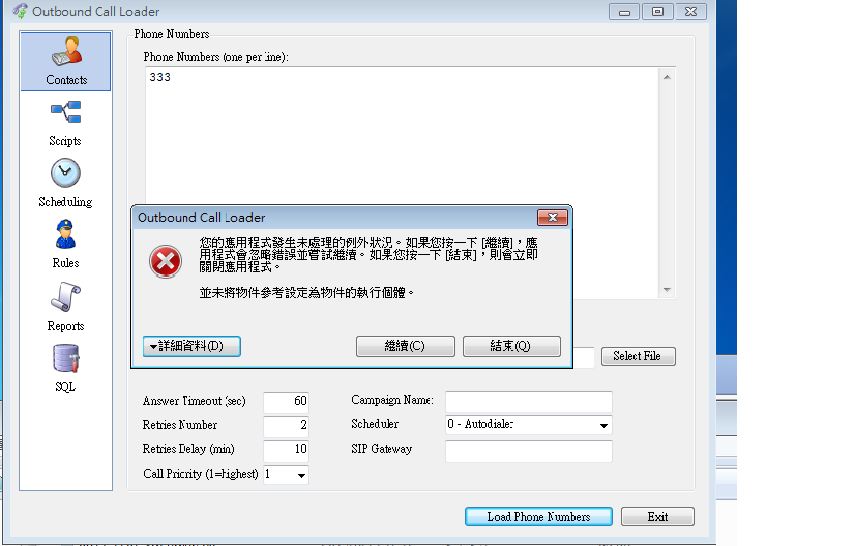

zhang19min88 Report post Posted 08/14/2014 09:34 AM when I use outbound call loader to load phone number, the system show me a message box .It shows something goes wrong. please see the attachment to get more detail .thanks. My system is:windows 7 Service Pack 1 CPU: Intel® Core2 Duo CPU E7500 @2.93GHZ system type: 32bite vg.zip Share this post Link to post

SupportTeam Report post Posted 08/15/2014 12:34 AM Does the error occur when you start the application, or when you make a particular selection/click/kepress ? Share this post Link to post
zhang19min88 Report post Posted 08/15/2014 12:53 AM This error only happen whwn I click the "Load Phone Numbers" button. I can make a call to voiceguide ,it work well. Share this post Link to post

SupportTeam Report post Posted 08/17/2014 03:45 AM The bug should be fixed now. Still not sure why it happens on Chinese version of Windows and not on the English version, but the in-code workaround included in app now allows you load telephone calls using the Telephone Number Loader. Share this post Link to post
