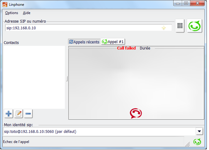

Guest Joe_supra Report post Posted 12/31/2014 07:09 PM Hello, i have successfully installed the HMP driver after formatting the PC When i user Linphone to place a call, i got "Call failed" on linphone I can't see any SIP packets arriving on Wireshark..(attached Linphone screenshot) Thanks ! Joe Share this post Link to post

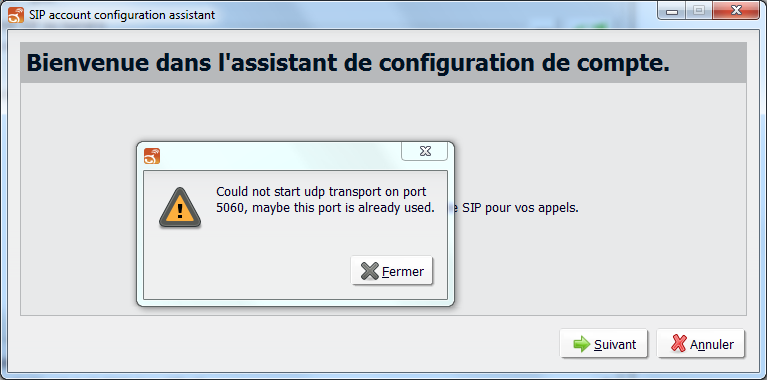

Guest Joe_supra Report post Posted 12/31/2014 07:26 PM additionnal information: I have restarted the pc and the i got another behavior of Linphone (please see screenshot-2) It looks the port 5060 is already used. When i check the processes i see that 5060 is taken by IpMediaServer.. so i'm a bit lost.. Thanks you Joe Share this post Link to post
SupportTeam Report post Posted 12/31/2014 11:24 PM The calls into the Dialogic HMP system need to be made from different machine. Linphone or any other VoIP software should not be installed on the machine running Dialogic HMP. Share this post Link to post
Guest Joe_supra Report post Posted 01/01/2015 03:28 PM works! thanks Maybe this should added on the helponine file Happy new year to all Joe Share this post Link to post
