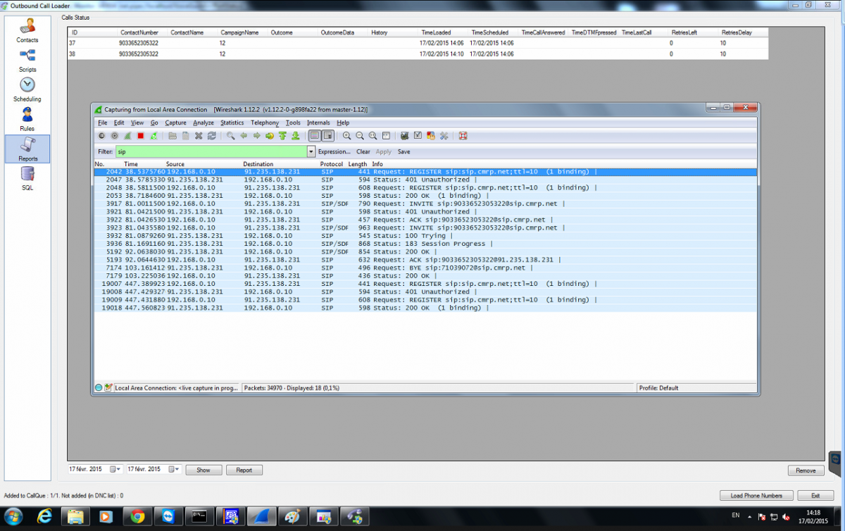

Guest Joe_supra Report post Posted 02/15/2015 09:48 PM Here is the wireshark trace for Voigeguied Startup and outgoing calls (in the meantime) I'm trying to make incoming call.s. still cant do it .. im waiting the provider to roote the DDI thanks Share this post Link to post
SupportTeam Report post Posted 02/15/2015 10:14 PM Please save that trace as a .pcapng file and post the file here. Share this post Link to post
Guest Joe_supra Report post Posted 02/15/2015 10:23 PM Please find the wireshark capture Share this post Link to post

Guest Joe_supra Report post Posted 02/16/2015 01:12 AM I tried but still issues..for options I tried both versions .. please find the logs Thanks capture2.zip Share this post Link to post
SupportTeam Report post Posted 02/16/2015 01:18 AM The authentication on outgoing call is now working, and the new authenticated INVITE is re-issued by HMP/VoiceGuide, but now we get back a 404 which means that call cannot be routed. You need to contact SIP service provider and ask them why their Asterisk PBX is responding with a 404 instead of routing an authenticated outgoing call. Forward to them the attached WireShark trace which shows what is happening. 404 on outgoing call.zip Share this post Link to post

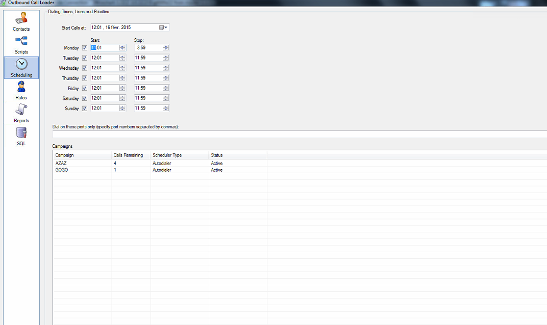

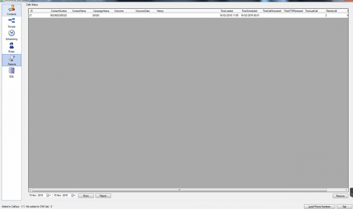

Guest Joe_supra Report post Posted 02/16/2015 11:02 AM Hello, I have sent that to the service provider and waiting the anwser. I let you know when i got the feedback . In the meantime i would have 2 questions on the outgoing call loader (see screen shots) - _Outgoing_1: Why does the TimeSchdeule set to 00:01 where i have loaded the number at 11:55 ? is there somehting wrong there - _Outgoing_2: How can i specify am/pm time slots.. i only have 1:00 to 12:00 ? thanks Mz Share this post Link to post
SupportTeam Report post Posted 02/17/2015 12:19 AM The "TimeScheduled" is set on the Scheduling tab. And we can see in the second screenshot that the scheduled time is set to be 12:01AM on 16th February, so the call was loaded as set. Call will be dialed if the scheduled time is equal to or older then the current time - so loading a call with a time older then current time will still result in call being made immediately. Regarding the AM/PM not being seen on the Scheduling tab, is the system perhaps set to use 24-hour clock, or is the default way in which the time is reported is the 24 hour time? The AM/PM should be displayed. What is the language setting on this system? Is "AM/PM" used when writing the time in that language or is a longer expression used? Is it possible that the longer way of writing AM/PM is just not fitting into the time textbox? Share this post Link to post
Guest Joe_supra Report post Posted 02/17/2015 01:28 PM Hello, My PC is in EN language and I dont see AM/PM and if i had a longer format i would see 00h to 24h . on the tab i have only the choice from 1h to 12h so i dont know if we are talking about AM ot PM so impossible to know if when calls are supposed to start and stop... Like the example i have attahcheed where you see the schedule timeis older than the clock time and the call does not go. I have attahced logs ans screen shots Tkx Joe capture3.zip log.zip Share this post Link to post
Guest Joe_supra Report post Posted 02/17/2015 01:50 PM i have solved the timeformat issues. It was due to the wrong date format from the Windows regionnal options : intl.cpl Share this post Link to post
SupportTeam Report post Posted 02/17/2015 11:25 PM Good to hear it was resolved. So you now see AM/PM in the time textbox? Did you change the "system locale" or something else? Share this post Link to post
