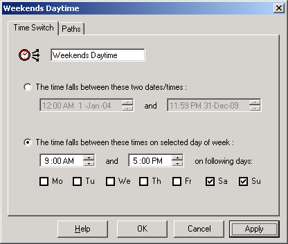

Next version of VG will have a "Time Switch" module which makes the switching based on time/date much easier:

To do this in the Time Switch module you would just specify the start date/time of the closure and the end date/time of the closure. Then if the call is made within this time the "True" path is taken which would lead to the module which says "We are closed for xxxx holiday".
