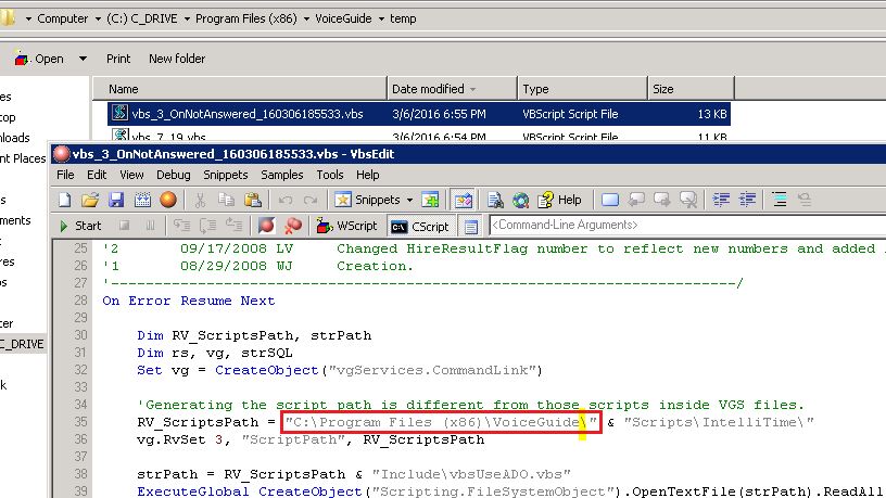

It is to be upgraded from same 7.5 version. Please see the screen shot below.
And I can assure you this vbs file in question is currently running fine without trailing "\" on other 7.5 instances.

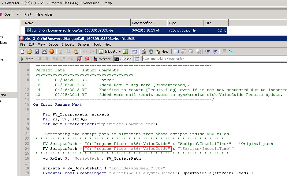

Please see the following screen capture I got from one of the customers who are using the 7.5 version before this fix: It DOES have "\" at the end of the value for "$RV[PathApp]".
The next screen shot is a compiled file from the server with your current fix: You can see the value does not have "\"
Please note that I added the comment in the code:
"Generating the script path is different from those scripts inside VGS files"
This is in order to remember that the result variable returned different values (with or without "\" according to the location where it is called.)
This VBS file (that executes upon "NoAnswered" case) is stored in "C:\Program Files (x86)\VoiceGuide\Scripts\IntelliTime\VbsExecutable", which is a sub folder of the place where all the vgs files are stored.
So it seems, if this RV is referred from VGS files, it returns without "\", but if this RV is referred from another folder (i.e. sub folder), it returns with "\".
Now with this new version you have provided, it seems the RV returns the path without "\" regardless of where is it called.
Let me know whether you will keep this new behavior or not so that we can decide to change our script accordingly, but please note you did change the behavior of the returned result.

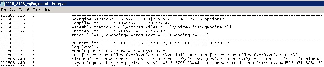

Instead, I included the log and the temp file that was generated several days ago, and the original VBS file with the current folder structure.
Since the log (3/6/2016) did not include service startup, I restarted the service to capture this information.
This is all I can provide regarding the path issue.

Looks like right now once the call is answered the $RV[PathApp] is set to value that does not have the trailing "\". This is for both incoming and outgoing calls. The time the $RV[PathApp] is assigned can be seen in vgEngine trace file.
But before the call is answered the $RV[PathApp] has a value that does have the trailing "\".
So right now if an outgoing call is never answered then the "OnNotAnswered" and "OnRetriesEnd" scripts will have $RV[PathApp]replaced with a directory path expression that does have the trailing "\".
The convention adopted in VoiceGuide is that the path related variables should not have a trailing "\". The software will be modified to change the "before the call is answered" $RV[PathApp] value to not have the trailing "\" - matching the value of the $RV[PathApp] is set to after call is answered.

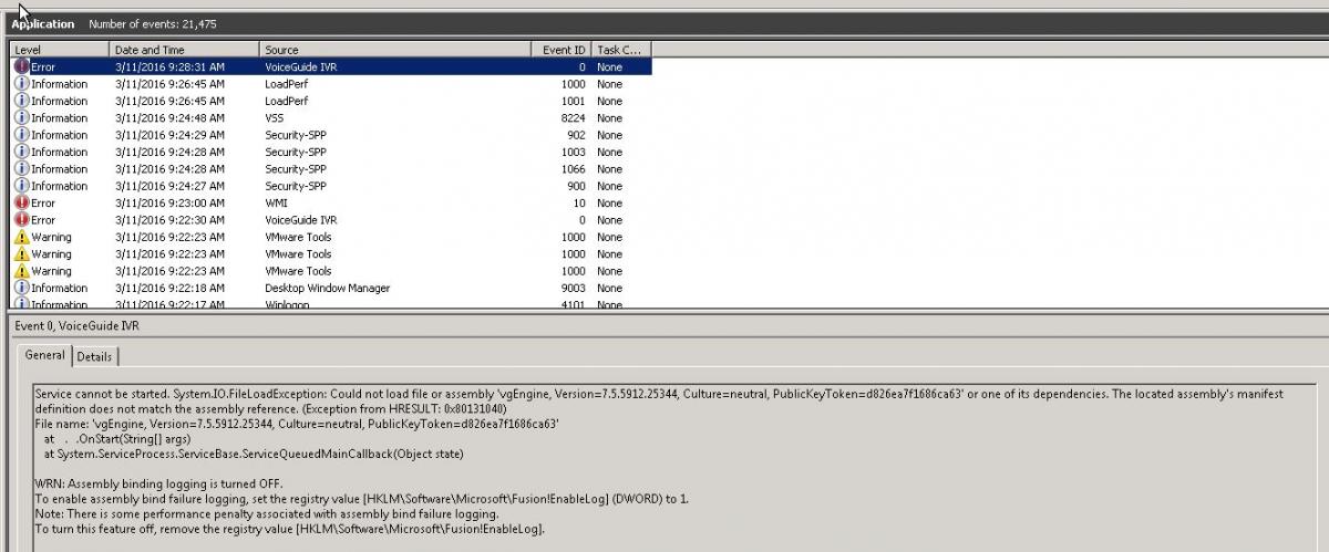

BTW, the provided recent patch does not work: VG stops as soon as it tries to start. And I see the following error from the Windows Event Viewer (Attached screen shot)
No log files have been generated either.
I restored the previous one (VoiceGuide_7.5.1_160309_hsdw.exe) for now, but it will be much appreciated if you can provide the stable patch as soon as possible (our customer's waiting)
