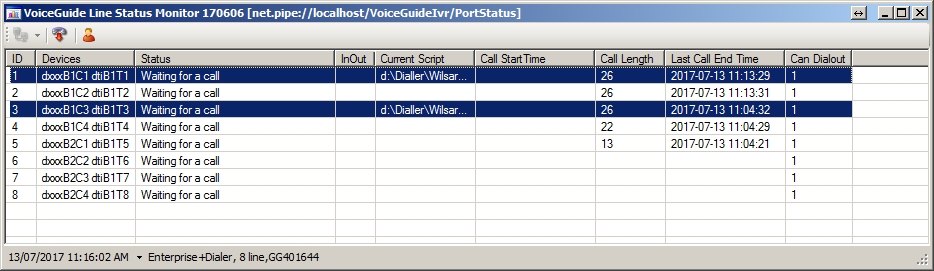

We have upgraded Voiceguide to latest version, but continue to have this issue. In fact it appear to be much worse now, and we end up with all lines on the server being locked out.
I have attached a log file where 2 lines have locked out and will not take or make any further calls. You can see the two lines highlighted in the screenshot of the Status Monitor.
If we set the lines out of service and back in service, they start taking calls again.

On both ports 1 and 3 the outgoing calls were not answered and system received a DISCONNECTED message back from ISDN network about 25 seconds after the call was made.
Traces show the call dropping and releasing on the two lines that showed a 'Current Script' was performed as usual from the Dialogic/VoiceGuide side.
Same as for the other dozen or so calls handled by the system and included in supplied traces.
From Dialogic/VoiceGuide point of view all ports on system were in a state ready to receive and make further calls.
The 'Current Script' field continuing to show a script filename even after call ended is a minor bug. It does not indicate that the line is 'blocked' in any way.
The 'Current Script' field display bug now occurs in some cases when a longer VoiceGuide script is used as one of the 'After Call' scripts (instead of a single .vbs or .bat etc).
We will fix this status display bug in next version of VoiceGuide v7.

Please find updated log and screenshots attached.
The lines where the Current Script continues to display, are the ones that seem to lock out and no more calls go out on them. However we noted that one of them did seem to recover, but the other 2 in this example (lines 2 and 5) did not, and multiple calls out skipped these lines. If we left it running over night, eventually all lines would lock out like this and no more calls would go out until VG is reset.

These traces better show what is happening.
Looks like If a VoiceGuide script is used for the "OnHangup" and "OnNotAnswered" etc. then if any modules in that script are set to "Wait until Program/Database/VBS Completes" then this can occasionally interfere with how the line state is reset.
So if you change all the "Database Query" type modules in the "OnNotAnswered" script to operate on "Do Not Wait for SQL Command to Complete" basis then this should stop this issue from occurring.
We will release a version that fixes this bug soon.

New version now installed. However lines are hanging on after hangup script in database modules and never clearing. Logs attached.
FridayLog.zip
The vgEngine log file ends at 16:36
Screenshot was taken at 16:42
Can you please post log file that includes traces up to 16:42

This version appears to be working a lot better, we are not getting all lines locking up now.
However we have noticed 1 line locking out, and we are seeing a module staying on the VG monitor after the call ends. It does not appear to be stopping future calls going out on that line.
I have attached a screen shot of both occurrences along with corresponding logs.
Also, will future versions of VG include the change you made to fix this issue or are we likely to encounter it again if we update to future releases?

Looks like there was another bug that occurred when a VoiceGuide script is used as the "OnNotAnswered" event handler, and multiple "Database Query" modules are used in that "OnNotAnswered" handler.
Please try the version below. The version below makes a change to how the "AfterHangup"/"OnNotAnswered"/etc. scripts are ran. VoiceGuide will no longer wait for the Database Query modules to complete in those scripts. The 'Success' path will be taken immediately.
ie. it forces the "Do not wait to complete" mode of operation in all modules in VoiceGuide scripts that are ran as "AfterHangup"/"OnNotAnswered"/etc.
