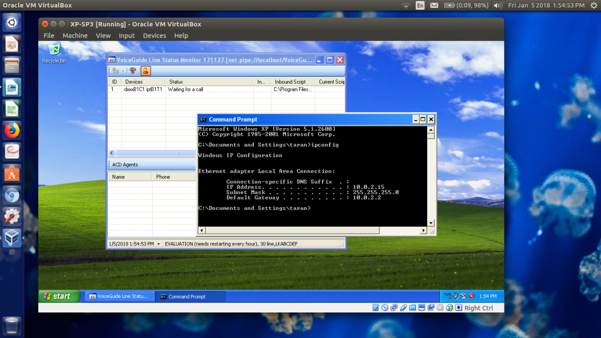

I have windows xp which is a virtual machine on a Ubuntu host.
The windows has HMP3.0 and VoiceGuide 7 installed and running.
The screenshot of ipconfig run of windows while IVR is running is attached herewith.

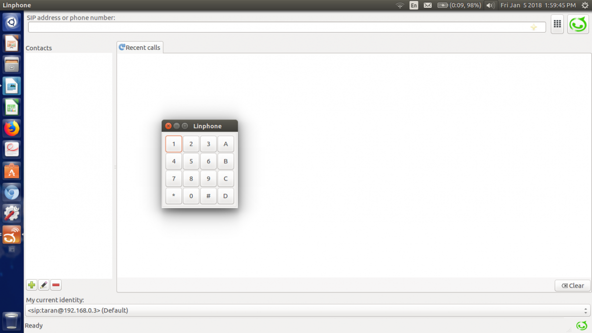

Also attached is the screenshots of Linphone running
Please guide me how do I use sip phone which is installed on Ubuntu ?
Screenshot shows the IP address of the Windows machine running VoiceGuide is: 10.0.2.15
Your Ubuntu ipconfig is reporting IP 192.168.0.3
Is 192.168.0.3 the machine that you are running the Linphone on?
Is the 10.0.2.15 VM running on the 192.168.0.3 system?
Can you ping that IP address from the machine that is running Linphone?
If the Windows machine can be pinged then all that you need to do is to enter 10.0.2.15 in the Linphone text box where it says "SIP Address or Phone Number"
