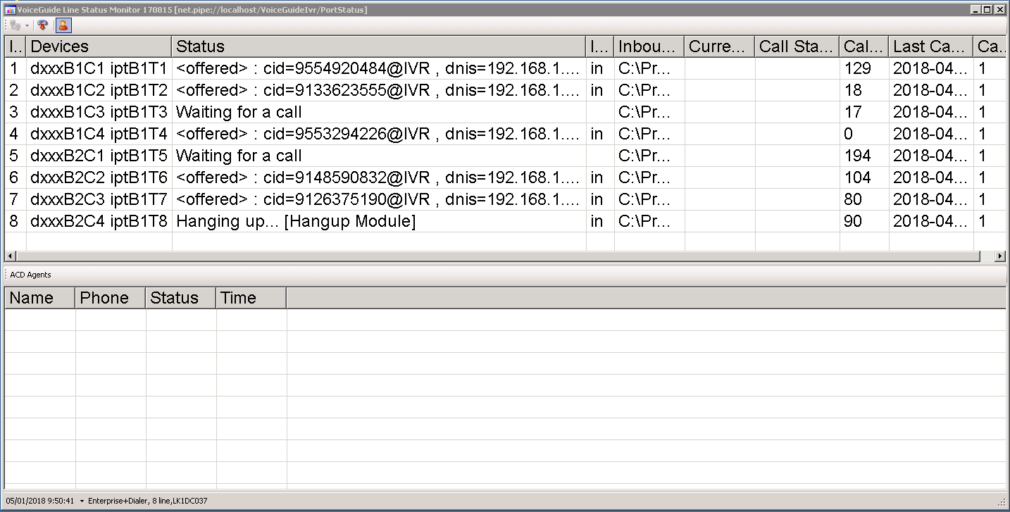

I have opened today my VG server and i have found out the status monitor screen as in the attached image and i could n't hang up any of the calls , i appreciate your support regarding this matter because the service was completely stopped on 29 and 30 of April even the free channel which is were waiting for calls were not working.

Traces show that the Dialogic HMP would not answer calls on 28th April, returning TASKFAIL to VoiceGuide's 'AnswerCall' requests,.
